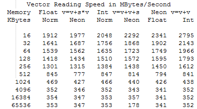

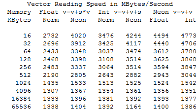

NEON Speed Test v1.0
Raspberry Pi 3 Model BRaspberry Pi 2 Model B
NEON technology was added with the Raspberry Pi 2, so it is not possible to test it on the Pi 1 Model B+, however I had not seen any benchmarks that had actually put it to the test until now. This increase in speed result should mean that the Pi 3 is faster at handling calculations relating to video, vector graphics rendering (so gaming and 3D) and potentially audio processing. Again it is interesting to see the point at which the performance starts to fall off.
There was also another NEON related test, which was the Linpack Single Precision Benchmark. This related the speed to MFLOPS, the Pi 2 came in at 299.93 MFLOPS and the Pi 3 at 462.07 MFLOPS.

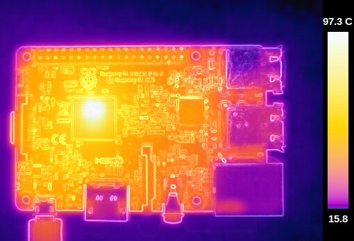

Bonus Coverage: Temperature
This was not by me, turns out the Raspberry Pi 3 runs hotter than previous models, enough that it should require a heatsink, and ventilation if contained. I discovered this was the case with the Raspberry Pi 2 overclocked to 1.1Ghz, so it makes sense. Though you will encounter people that claim the Raspberry Pi does not need cooling, I think we may see a change.
If I had a thermal camera, I would do a shot of every Raspberry Pi. That would be awesome. Oh, SOMEONE DID!
