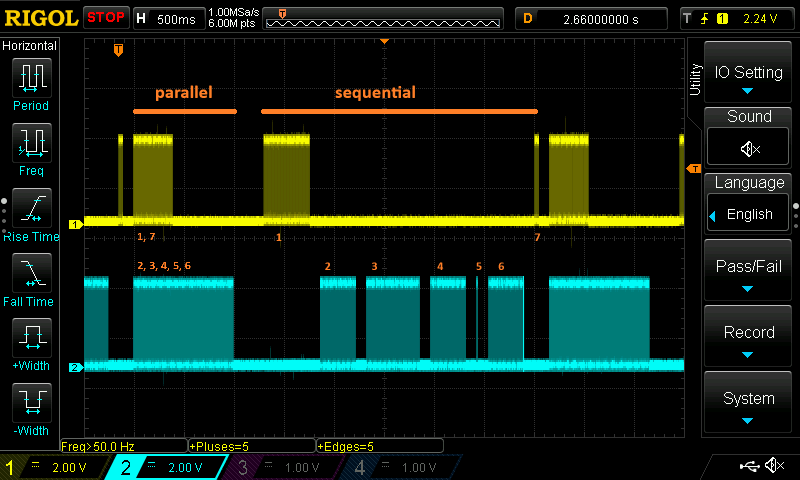

This exercise uses the library to control 2 motors. A few scenarios are shown:
  • all commands run in sequence
  • each motor picking its commands and run them all in parallel.
you don't need stepper motors or driver ICs to test this. If you have an oscilloscope, you can see what's happening..
Probe these pins:
  • GPIO4: motor 1 DIR
  • GPIO5: motor 1 STEP (the pulse train)
  • GPIO6: motor 2 DIR
  • GPIO7: motor 2 STEP (the pulse train)
In this exercise, I probed GPIO5 and GPIO7.

This function gets a set of commands, and the speed for each motor. What happens?
  • speed is set
  • the count of steps to do per motor is retrieved, by looking into the command batch
  • commands are sent to each motor. They start immediately
    in parallel, the callback will start decrementing the relevant command counters each time a notification from PIO arrives
  • code waits until the total amount of steps has been taken
Demo preparation: batch of commands
This is the set of 7 commands used in the demo. The first and last are run on the first motor. The others on the other one.
    std::array<motor_command, 7> cmd{{
        { {200 * microstep_x, true}, 0},
        { {200 * microstep_x, true}, 1},
        { {300 * microstep_x, false}, 1},
        { {200 * microstep_x, false}, 1},
        { {10 * microstep_x, true}, 1},
        { {20 * microstep_x, true}, 0}

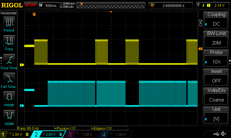

Demo: 7 commands in parallel
In the first demo, each motor picks up its own commands, and executes them right after each other. Motors run independently, at different speed.
The first motor will immediately execute the first and last command, and the second one immediately runs the middle 5.
The demo finishes when both motors have run the commands.

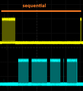

Demo: 7 commands in sequence
In the second demo, each command is sent after the previous one is completed.
There is not a lot that you need to different. Just send the commands from the batch one by one...
void full_demo(const commands_t & cmd) {
    // TODO: stepper driver IC should wake up here, if not yet
    // sleep_ms(1);
    // demo: run all in sequence
    for (auto &c: cmd) {
        std::array<motor_command,1> single_cmd {{c}};
        run_commands(single_cmd, 9000, 7000);
    // TODO: stepper driver IC can go back to sleep here
Both strategies can be intermixed. The gaps in the traces are for demo purposes, to have visual markers.

    Jan Cumps over 1 year ago
    4 motors on 1 PIO block -
    1. running commands in sequence
    2. running all commands concurrently
    Commands:
            { {300 * microstep_x, false}, 2},
            { {200 * microstep_x, false}, 3},
            { {10 * microstep_x, true}, 2},
    > The gaps in the traces are for demo purposes, to have a visual markers.
    Here is a capture with the "demo sleeps" removed.
    The gaps you see here, are when I ask the firmware to run steps sequential, and one motor waits for the other one to finish its step(s):
