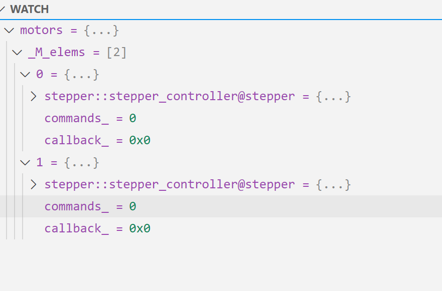

    Jan Cumps over 1 year ago in reply to shabaz
    a few posts that will help:
    • the multiple motor firmware design explained:  Raspberry PIO stepper library documentation - 3: control multiple motors with 1 or more PIOs
    • clock divider, delay, and stepper frequency explained:  Raspberry PIO stepper library documentation - 4: understand the step frequency

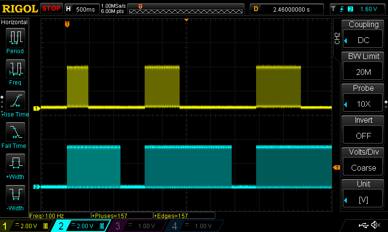

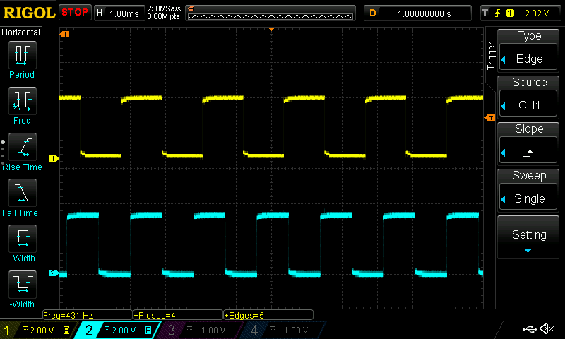

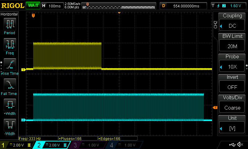

    Jan Cumps over 1 year ago in reply to Jan Cumps
    ... and 2 motors running in parallel at different speeds:
