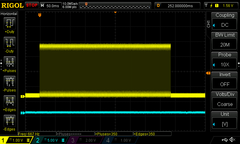

Here's how this looks like on a scope. Blue is the direction pin.
The video near the start of this blog shows the same sequence, but I added a little pause between the steps for visibility.

    A test to see if the PIO actually generates the amount of steps that I request. In this case: 350. I've used my oscilloscope's pulse counter to do the work for me. It's a match.
