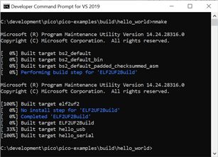

Now to build the code, the environment variables for Microsoft build tools (particularly nmake) might not be set up properly to work in PowerShell. If you get an error, switch to using Developer Command Prompt for VS 2019 instead.
Open up the prompt and navigate to the build folder as before, and then just type nmake
It will start building all the examples (it will take a while).

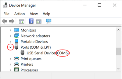

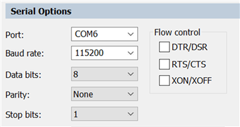

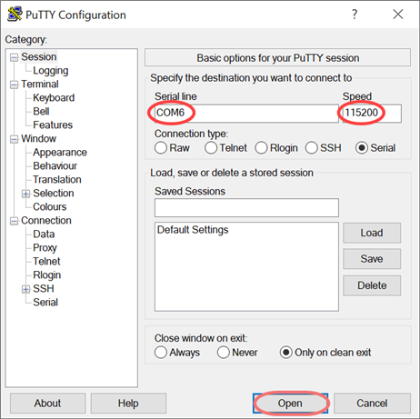

  1. Write code to light one or more LEDs, to indicate success or failure to reach a certain point in the code, or a data value
  2. Use printf statements to send text based debug information via USB to the connected PC. The PC will see a serial connection that can be used with software such as PuTTY to view the debug. You can also capture user keyboard input too, using (say) the scanf function.

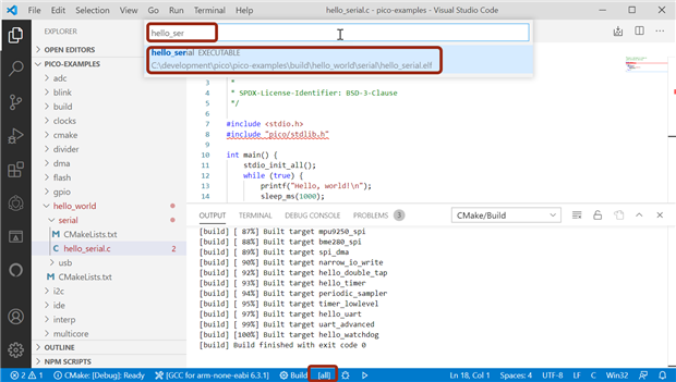

    EDIT: Figured it out. In the blue bar at the bottom, the build target is 'all', but if you click on that, you can then see a complete list of available targets. You can then type to narrow down to the one of interest, such as hello_serial in the hello_world folder. Once you've done that and selected the correct one, it appears in the blue bar and will get built when you click on Build in the blue bar.

    Does anyone know how to re-build/compile a single project folder in the pico-examples after it has been modified ?

    Thank you for this helpful set of steps; for some reason the CMake:Generator was missing from my setup but once I completed the field to match yours all carried on smoothly image
    At first all the projects withi my pico-examples appeared to contain just a single c-source and text file....then I realised there was also a build folder, like you have in your screenshots, where everything repeated again and that is where they had been compiled to. So probably just something in my initial attempts to set this up.
