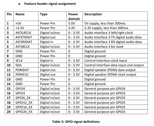

The previous Wolfson card has a 26 pin header with male pins to connect to the Raspberry GPIO header after pushed on top of it. Does the new audio card do the same for the 40 pin header? Sorry, but I cannot discern from the card images I have.
  • fvan
    fvan over 11 years ago
    There is a table in the user manual with the remaining I/O on the expansion header.
  • tonyhansen
    tonyhansen over 11 years ago in reply to fvan
    In this table (e), pins 16-20 are ALL described as "General Purpose Pin GPIO 3", which looks to me like a copy/paste error from the pin 15 description.
    It would be nicer if table (e) were to read:
    PinNameType
    Power
    Domain
    Description
    17GPIO6_EXDigital In/Out0 - 3.3VRPI General Purpose Pin GPIO6 (RPI pin 31)
    18GPIO12_EXDigital In/Out0 - 3.3VRPI General Purpose Pin GPIO12 (RPI pin 32)
    19GPIO16_EXDigital In/Out0 - 3.3VRPI General Purpose Pin GPIO16 (RPI pin 36)
    20GPIO26_EXDigital In/Out0 - 3.3VRPI General Purpose Pin GPIO26 (RPI pin 37)
    However, there are discrepancies between this table (e) and the description within the schematic that need to be figured out.
    Pins 10 and 11 are flipped between the schematic and table (e). (In the schematic, pin 10 is listed as PDMOUT_DAT [3] while table (e) says pin 10 is SDA. And vice versa for pin 11.) Which is correct?
    In the schematic, pin 14 is listed as connected to "GPIO5_EX [7]", which SHOULD correspond to PI GPIO 5 (PI pin 29). However table (e) lists pin 14 as being GND. Which is correct?
    In the Cirrus Logic Audio Card Comparison Table, it says that there are 8 PI connections (including the UART). The UART is connected to the Cirrus J8 Header. (RPI pins 8&10)
    Can anyone confirm definitively which are the other two GPIO pins that are tied directly from the PI into the Cirrus expansion header?
    • Expansion header pin 15 and 16 are marked GPIO4 and GPIO3, but those appear to be connected to GPIO4&3 on the WM5102_CSP137 chip instead of the RPi GPIO pins.
    • Pin 14 might be one of them if the schematic is correct but table e is not.
    Any definitive clues?

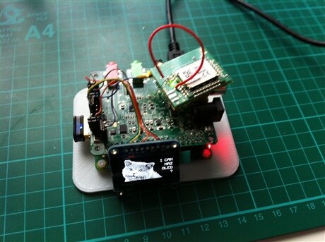

    I have some comments about using "semi free" or "unused" GPIOs of Cirrus Logic AC. I mean GPIOs 04, 24, 25, and 27.
    In my project I use RPi with CLAC and SleepyPi to make battery powered field recorder for animal sounds. To make possible these three boards be connected I had have to make an adaptor from Exp. header of CLAC to Sleepy. To managing power of Rpi Sleepy needs GPIOs 24 and 25. 25 is present in CLAC Exp. header, so at the beginning I wanted to use it as is. But it didn't work, and when I checked voltage on this pin, my multimeter showed 0.7V, but not 3.3V. I measured this pin voltage in all combinations of boards (I have Rpi B+, couple of RPi A+, two CLACs and two Sleepy Pi) - results were the same. On Rpi without audio card and normal Raspbian loaded, those GPIOs of course had 3.3V when I switched them to High. Finally I have used "true free" pins from Exp. header, and everything is working properly.
    Thus, these pins (at least 25th), it seems, can not be used as normal GPIOs, despite the fact that they are unused in this version of the CLAC driver.
    e14 Contributor over 11 years ago in reply to e14 Contributor
    Thanks for the feedback. We believe we have discovered and resolved the cause of the problem in the 3.18 driver which has been just been released. The GPIO pin of the WM5102 was incorrectly configured as an output, in the 3.18 driver this is now configured as an input. This issue was stopping the use of GPIO25 from the Pi as reported by Ivan W.
