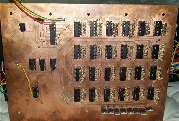

    Bit wobbly after I moved it between home and work a few times, I've given up straightening everything,,,, that is until everything works as planned.image

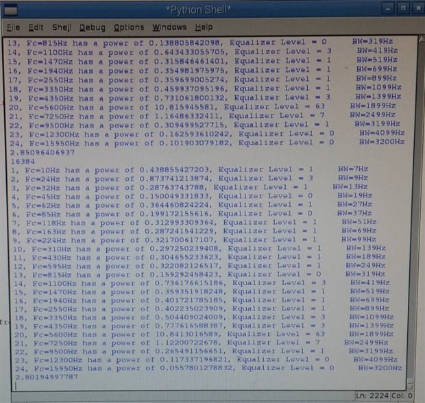

    The output of the FFT is grouped into 24 bands, the FC denotes the center frequency. On the far right is the BW. The power level is the average power of the individual frequencies in that band. The final output that is sent to the PIC is a scaled value shown by the equalizer level, note: an Equalizer level of 63 in binary is 0011 1111 which will show an amplitude of 6 LEDs being illuminated on the array.
    I ran the python program in the previous post with a 3.5mm audio cable plugged in between my phone and the cirrus logic cards line in. I used an app called "PA tone"  (which is free) to generate a 5000Hz Sine wave tone out of my phone. The results show the tone in the 20th band, with an FC of 4350Hz and a BW of 1899Hz (which is 3400Hz to 5300Hz). I found some noise present in unused bands no matter what frequency I generated. I put that down to noise in the phones output or on the line, poor handling of the FFT output (my fault) and digital noise in single precision numbers which can become collectively significant when summed. But clearly the frequency amplitude of the 5000Hz wave is the most significant.

    OMG ! image Awesome ! how much time it took to build image
    0 e14 Contributor over 10 years ago in reply to scitechindian
    Hi SYED. It took 5 days with 2 people soldering to build the LED array (approximately 80 Man hours). It took me 3 days to design,route and solder the PCB. It took one full day to join the wires to the board and It took about 2 days to program the PIC.
    But it has taken me about 2-3 weeks to research and develop the code on the raspberry pi, since I have never touched one before this.
