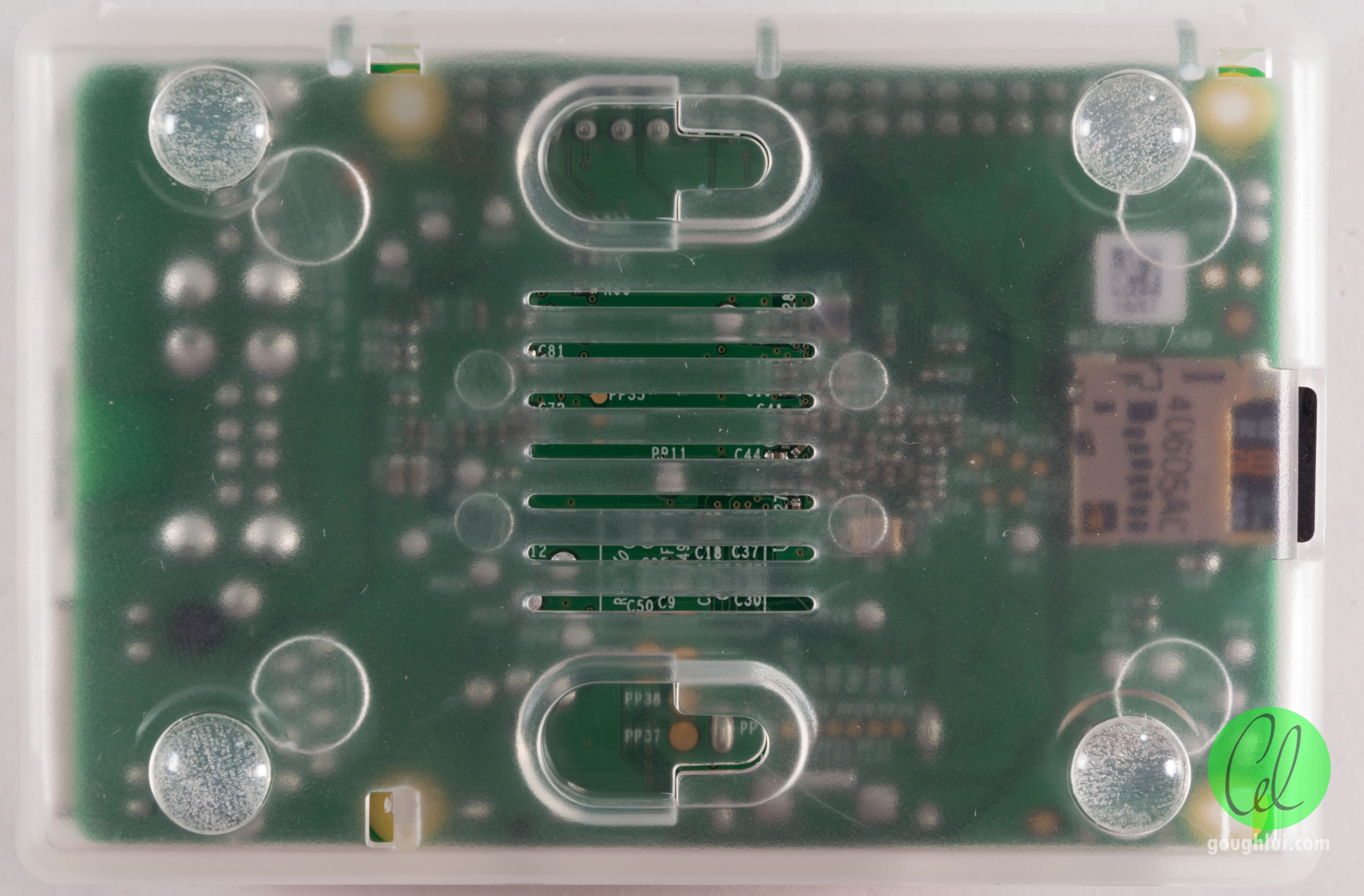

    The coloured screen generally indicates a failure to boot from the MicroSD card. Can you provide details of what type of MicroSD card you are using, and how you imaged it, and whether you used the latest 2015 Raspbian or Noobs images? Please check the card is inserted correctly - it should be firmly "clicked in" to the latching slot, with the text facing the bottom side of the Raspberry Pi. It should not protrude from the board by much - it should look like this: http://cdn1.goughlui.com/wp-content/uploads/2014/08/DSC_7716.jpg

    Seeing as the files in your card's root directory are dated from 2014, it seems that your card may have been a NOOBs card with an image from prior to the launch of the Raspberry Pi 2 and thus cannot be booted on the new Raspberry Pi 2.
    You should download a new NOOBs image from the Raspberry Pi foundation and write that to the card following the instructions here. There's a good chance that this will make it work.

    Thank you everyone.  Your replies taught me a lot. And the Winner is [Drum Roll] ...  Gough Lui.
    The SD  card that someone at Newark Element 14 told me was what I needed for the Raspberry Pi 2 Model B does NOT work.  Beware of SKU 68X3795.  The Pi 2 freezes on the splash screen and does not boot.  It took three days and help from Gough Lui before I worked up the courage to wipe clean the SD card from Element 14, using the recommended Format program.  Then I  downloaded the correct software from the Internet and everything worked beautifully.
