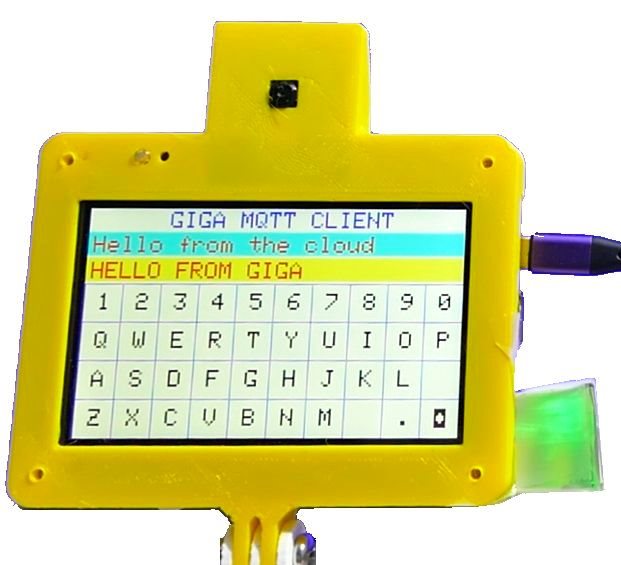

For quite a while now I have wanted to explore the idea of using MQTT as a text messaging system, where users publish and subscribe to a topic of mutual interest - forming an interest group.
The Arduino GIGA with its display is an excellent platform to implement this functionality, so that's what I did.
This is what it looks like:
GIGA MQTT Client
This image shows the texting MQTT client has a keyboard, a line of text to publish messages and a line of text to subscribe to message topics.
The green block on the right side is just a foil reflector, temporarily taped to the chassis, that allows the rear facing LED to be seen from the front.
Here is a little video that shows how it works.
GIGA MQTT Video
This MQTT client is using the Adafruit MQTT broker to demonstrate this text messaging concept. To use this broker you need to set up an account with Adafruit, but they have a free sandbox and a well described process to use it.
The Adafruit MQTT broker even has the tools to set up and run your own dashboards.
The messaging system I set up here just uses one topic for both publishing and subscribing, which means that when I publish a message to the topic, My subscriber will get an echo. I handle this by displaying the echo on my publishing line - essentially using it as confirmation that the message got received. The ">" on the right side of the publishing line is like a send button which disappears when the echo is displayed. Actually touching anywhere on the publishing line or above it will publish the message.
Editing the publishing line is very rudimentary. There is only a backspace button on the keyboard and the publishing button, but that is all I want. Simple and it allows any message to be edited before sending.
Messages are limited to 19 characters - not a magic limit, just an arbitrary number I chose that allows large fonts that are easy to see in a video demo. Actually, received messages can be longer, but if they are published by clone of this client, they will also only be 19 characters. Not exactly Twitter length, but a good demo for now.

The code uses a credentials file called creds.h for passwords etc. but the code above shows what is in the creds.h file in its comments.
I am not that keen on demos of software that need secret information, because you can't just copy the redacted code and expect it to work, but part of this road test needs to explore WiFi, which makes it unavoidable.
Discussion
I took me a while to get the code working, but it turned out to meet my objectives, which is always gratifying.
The objectives were to develop a system that would use MQTT to implement a text messaging system. Unfortunately I don't have two Arduino GIGAs to have them message each other, but pretty much any computer could be programmed to act as a similar client. Another objective was to explore a WiFi application using this GIGA..
This Arduino GIGA kit is extremely versatile, which makes it easy to develop complex applications and it is a lot of fun doing things that would be daunting with most other platforms.
