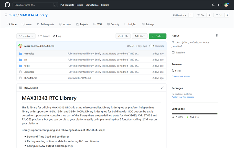

Library is available at Github. Source codes consist of library, platform specific ports and examples. Not all examples are implemented yet and all examples are not ported to all platforms because making all of them is very time consuming. Currently library is ported to STM32 platform (default pinout matches NUCLEO-L552ZE-Q board and PSoC 62 platform (default pinout and project configuration matches previously RoadTested Cypress PSoC 62S2 Wi-Fi & BT5.0 Pioneer Dev Kit (CY8CKIT-062S2-43012). In the future I plan to port library to other platforms which I use. I plan support AVR and also MAX32625 MCU which is part of bundled PICO board.

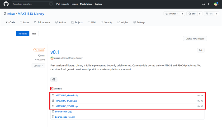

You can download latest version of library from release page at Github. You need to expand Assets section and select which platform variant you want to download. Alternatively, you can clone whole repository.
