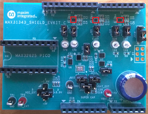

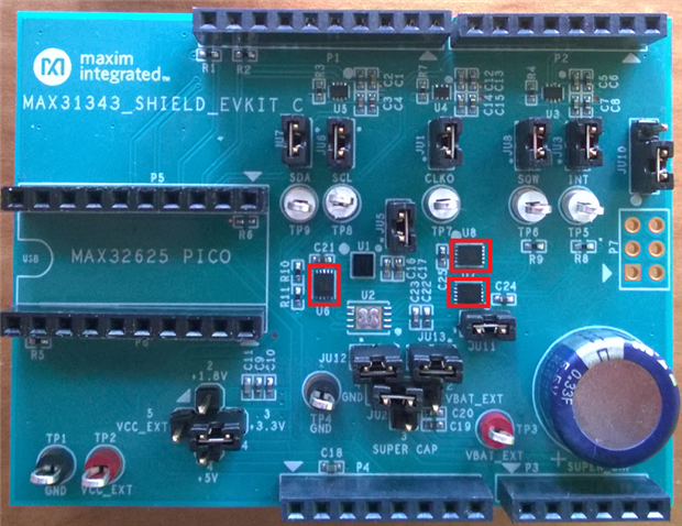

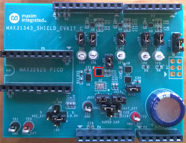

This shield is not an easy straight shield with only chip with chip routed to connector. This shield offers much more. Shield contains 7 chips. The main chip is MAX31343 RTC. It is in the middle of shield and it is referred as U1. Following image highlights this chip:
Shield is designed in a way that you can evaluate chip in both available packages (WLP and TDFN). We have seen WLP variant of chip on previous picture. TDFN variant is not soldered and you must solder it yourself if you want to evaluate it. I am not sure what is the reason for evaluating the same in different package because differences between viarants are minimal. Footprint for soldering TDFN variant is under WLP variant and it is highlighted by following image:

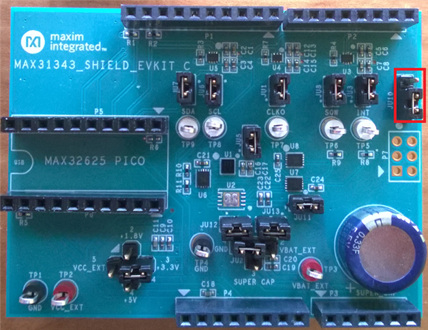

When you want to evaluate TDNF chip, you can select active chip using JU10 jumper. If you do not solder additional chip, you should let JU10 in default position:
Internally active chip selection is done using analog switches. Analog switches routes SDA, SCL, INT, SQL and CLKO signals to/from one of the chips according to JU10 setting. Analog switches are MAX14689 and they are highlighted by following image:

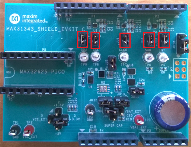

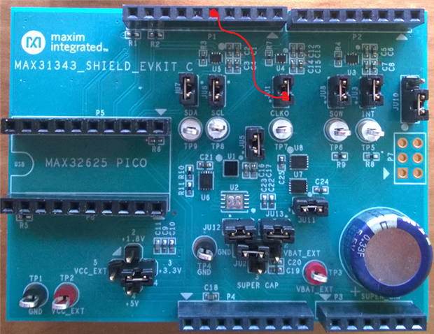

Each interesting signal is routed to PICO connector and Arduino connector. Each signal can be disconnected from Arduino connector using following jumpers:
This approach allows you to remap signals to any other pin using wire If you do not like default layout. You can disconnect jumper and connect wire between bottom pin of jumper to any pin you want. Please note that this approach bypass voltage level shifter and some passive components like pull up resistors, so you must provide them externally. Always consult schematic when doing this kind of hacks.

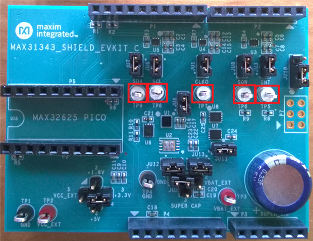

You can connect logic analyser to each interesting signal using test points:
Except signal test points, there are two ground test points and test points connected to external power supplies. Please note that these voltages are not power supply of chip and battery. If you want to measure Vcc and Vbat voltage I recommend using middle wire of power supply source selection jumpers as test point:

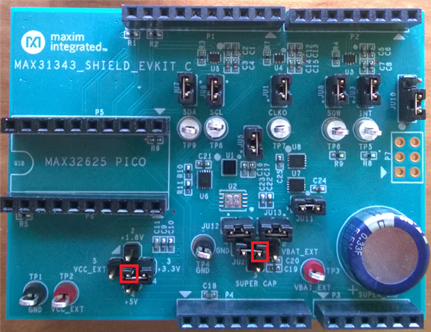

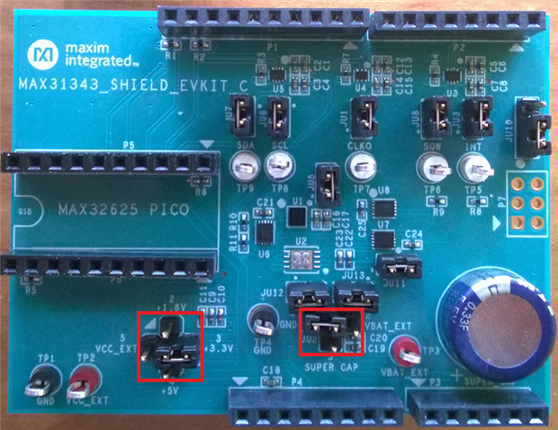

You can select voltage using jumpers forming star connection. You can configure Vcc and Vbat sources in this way:
Vcc you can select from choice of:
  • 5V
  • 3V3
  • 1V8
  • External voltage
Vbat you can select from:
  • Super capacitor
  • External voltage
  • No valtage (GND)
While it looks easy at first look, there are some strange parts about it which I will describe later. For now you can think what voltage you get when choosing 1V8 as Vcc and use board with Arduino (Arduino has no 1.8V on this connector)? Answer will be provided later.

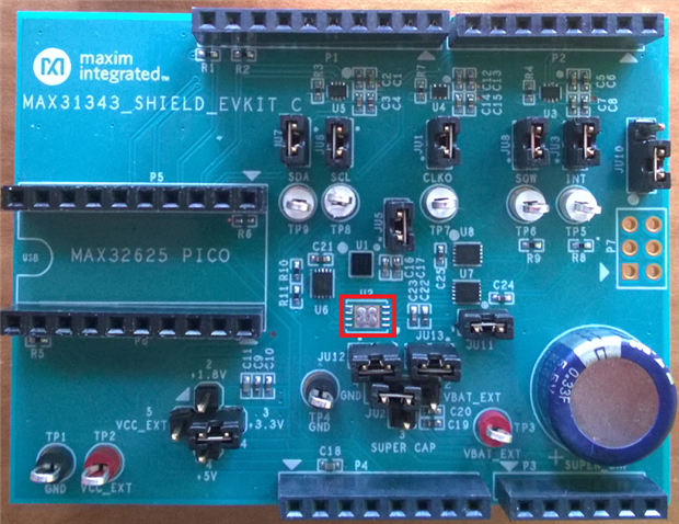

Last three chips near Arduino connector are voltage level shifters NLSX4373 (left and right) and NLSX4401 (middle) from ON Semiconductor. NLSX4373 is two-bit level shifter and NLSX4401 is one-bit level shifter. Level shifters convert signal voltage between Vcc and Vioref. Voltage shifters are highlighted by following picture:

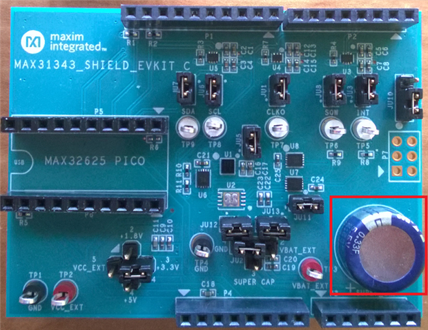

For backup power there is 0.33F (really Farads) supercapacitor from Epson. This is different approach than CR2032 battery. I will describe this later in more details. Following image highlights supercapacitor:

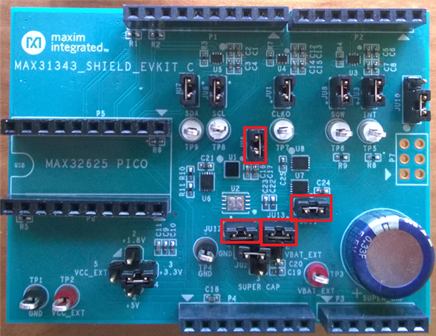

Last jumpers which were not described yet are designed from disconnecting power supplies to RTC chips. You can disconnect both Vcc and Vbat from both variants of chip. Jumpers are visualized by following picture:

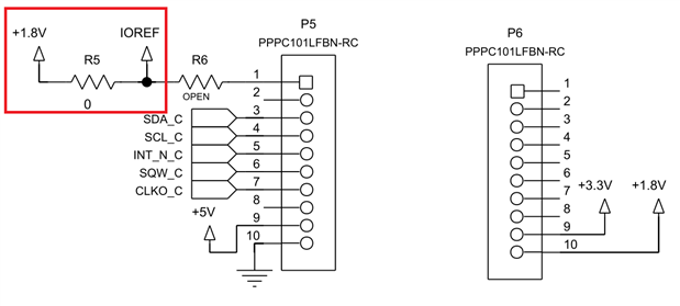

And what about Vioref? Vioref is “directly” connected to 1V8, so Vioref is 1.8V when powering using PICO board:
This schematic is interesting because it is not clear at the first look what is the purpose of this connection. This interesting connection resulted from PICO board design. PICO board featuring MAX32625 MCU supports powering IO pins of MCU by multiple voltages Vddio and Vddioh. It is designed to allow MCU control some pins by 1.8V and some other pins by 3.3V (but it is not limited to this value). By default, all pins are driven by 1.8V, so shield is designed in way. Because that shield expects Vioref is 1.8V. But this interesting design is more flexible. It allows you use 3.3V interface (Vioref) and for doing that you need to desolder R5 and solder 0-ohm resistor R6. Of course, you must remember to reconfigure firmware on MAX32625 to use Vddioh instead of Vddio on this pin. While you probably never will need do this modification, it shows flexibility of shield and its design. Second interesting thing is that it is that 3.3V voltage is not provided to Vioref from 3.3V pin on connecter but it is provided by pin which at the first look looks like normal GPIO pin. But this pin is connected using another analog switch on PICO board and PICO board firmware can using software configure this pin to providing Vddioh directly from voltage regulator. It is quite complicated and I recommend checking datasheet and schematics when using these advanced features.

Supercapacitor
Shield have supercapacitor used for backup power to RTC chip when it is not powered by main power supply. This is modern approach that behave differently than still very frequently used batteries like CR2032. While battery remains charged for years, capacitor for weeks. But capacitor is rechargeable (chip has configurable trickle charger), consume less space on PCB and do not require any maintenance. It is good in case when you know that device is at least once per week powered for some time. In this case capacitor will be enough to handle backup power over whole time without any maintenance.
Supercapacitors are expensive. How long capacitor remain charged depends mostly on how much you are able spend for it. How long capacitor remain charged also depends on powering voltage of RTC chip which charges them. For example, if you power MAX31343 RTC chip by 3.3V you will never charge backup capacitor to higher voltage. This should be problem especially if you want to use MAX31343 at low voltages like 1.8V. But when you are powering your device with for example 3.3 you can buy cheaper supercapacitor with nominal voltage less than 5.5V which is used on board. Roadtested shield features 0.33F supercapacitor. From 4.0V to 1.6V it takes between 1 to 2 weeks to discharge but note that chip also correctly works below 1.6V down to approximately to 0.9V. Of course, this is not guaranteed by datasheet and most probably it wont work under all conditions. At 0.9V chip stop working and sourcing any current from capacitor. Capacitor stop further discharging at stuck this voltage.
If you want to power chip by battery, you can connect it using external Vbat voltage which you can connect to Arduino header.
