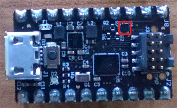

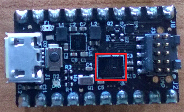

MAX32625PICO Structure

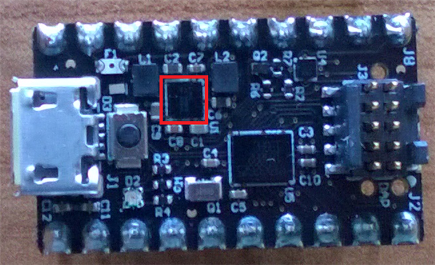

While board is very small and board is one of the smallest boards with MCU at market, it features 3 chips, lot of passive components, USB connector, 10-pin SWD connector for programming external MCU when used as DAP link, crystal and RGB LED. These are lot of components when you take in account size of board. Very interesting are 3 chips.
The largest chip is MAX32625 microcontroller. It looks large only on image. In fact, it is 3,8 × 3,0 mm and has 63 pins at the bottom of chip! MCU is highlighted on following image:
Second largest chip is MAX14750 and it is chip that integrated multiple regulators converting 5V input from USB to three voltages - 3.3V, 1.8V and 1.2V. It has many passives near it because some their regulator requires them. But when considered that it creates 3 different voltage levels, PCB space occupation is even when included passives very small. PMIC is highlighted on following image:
Last chip (the smallest) chip is MAX14689 which is analog switch and it is used for modification pinout behaviour on two pins. This is quite simplified description of its purpose, but fully complete description would be too long. This chip makes board even more flexible than it is. It is highlighted on following image:

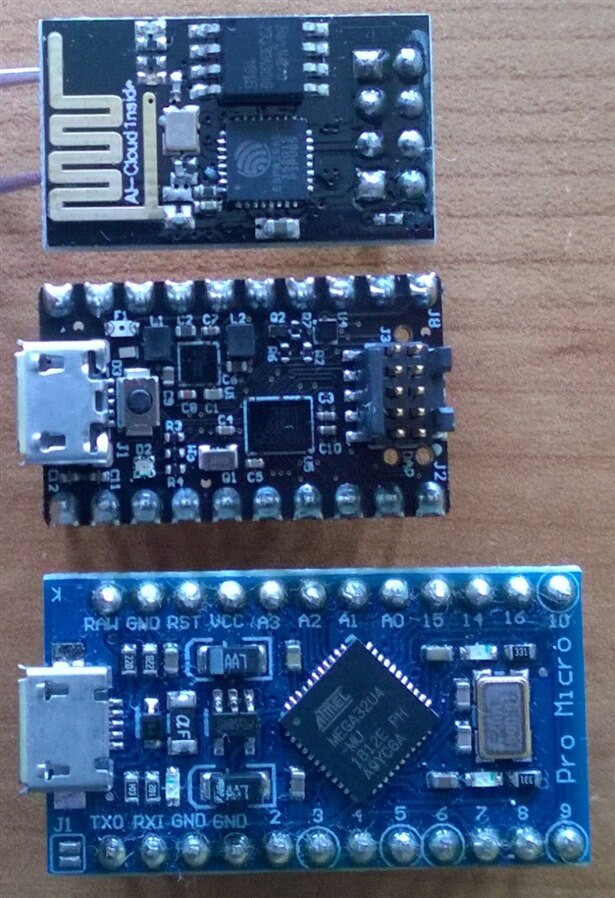

MAX32625PICO Comparison
Board is very small. On the following photo it is placed next to ESP8266 on ESP-01 module and clone of Sparkfun Pro Micro. It is very similarly sized to ESP8266 module but has much more pins exposed, also has exposed USB connector (which is not supported by ESP8266) and even on the same size contains regulator which can provide more flexible powering options for external components. But this comparison is not very clear because it compares totally different products targeting totally different applications. Much better is comparison with larger Sparkfun pro Micro. This board also supports USB, has lot of GPIOs but has much slower MCU with less peripherals, is less energy efficient and without modification or external level convertor supports only 5V components. In comparison with these boards MAX32625PICO looks like very flexible and powerful board and this I agree with it. The only disadvantage is that is quite complicated to program it and develop firmware for this MCU. This is most probably strong benefits of other two mentioned because they are programable simply using Arduino. In opposition MAX32625PCIO is only board with SWD/JTAG support for debugging which requires additional skills and need for owning some debug probe. Also note price of board. It is 13.20 USD at the time of writing at Newark while price of less powerful and flexible Pro Micro is 17.95 USD at sparkfun website.
