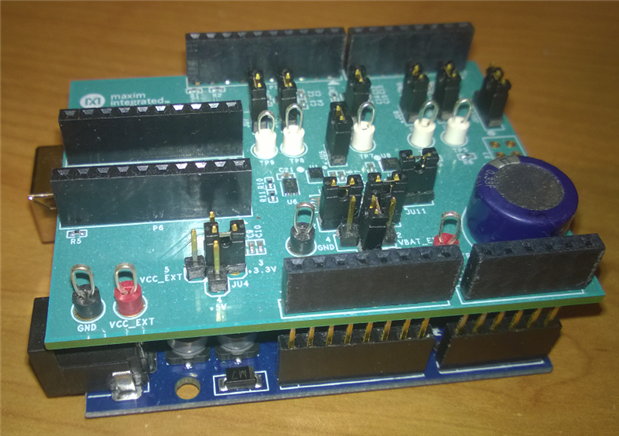

Jumper setup
I have described jumpers in chapter Review of Evaluation Shield ion more details then I will provide there. Now I will describe only recommended configuration for usage with Arduino. Most jumpers were configured correctly from the factory but some of them should be adjusted for correct operation.
At first you must connect jumpers connecting power supplies to chip. There are four jumpers related to this. Connect JU5, JU11, JU12 and JU13. All of them should be fitted by default.
You need to select which package variant of chip you want to evaluate. It is configured using JU10 and you should connect this jumper to bottom position (position near P7 connector) unless you soldered and want to evaluate second package variant. Jumper most probably came correctly fitted from factory.
Then you need to connect all signals to Arduino connector. Connect JU1, JU3, JU6, JU7 and JU8. All of them should be fitted by default.
At last you need to select source for main and backup powering chips. Select supercapacitor as a backup supply. It is done using JU2 and this is most probably only configuration which differs from original factory configuration. By default, no backup supply is selected, and backup supply is connected to ground. For powering chip in time when your Arduino is disconnected you must switch the jumper to bottom pin with label SUPER CAP. Main power supply you can configure using jumper JU4 and you can choose any of 1.8V, 3.3V and 5V no matter what Arduino you use. It is because board have voltage level shifters and as far as your Arduino provide correctly connected IOREF source, it will work correctly. This is good thing because you can safely set this jumper to position 5V (which is the best option for achieving most efficient backup super capacitor charging) even you use 3.3V Arduino (or other board with this connector).
Shield connection
Before you connect shield to your Arduino you need to disconnect PICO board from left connector. You should not have connected shield to both boards (PICO and Arduino) at once. Details about this restriction are described in chapter Review of Evaluation Shield. After disconnecting you can connect shield to your Arduino and power it.

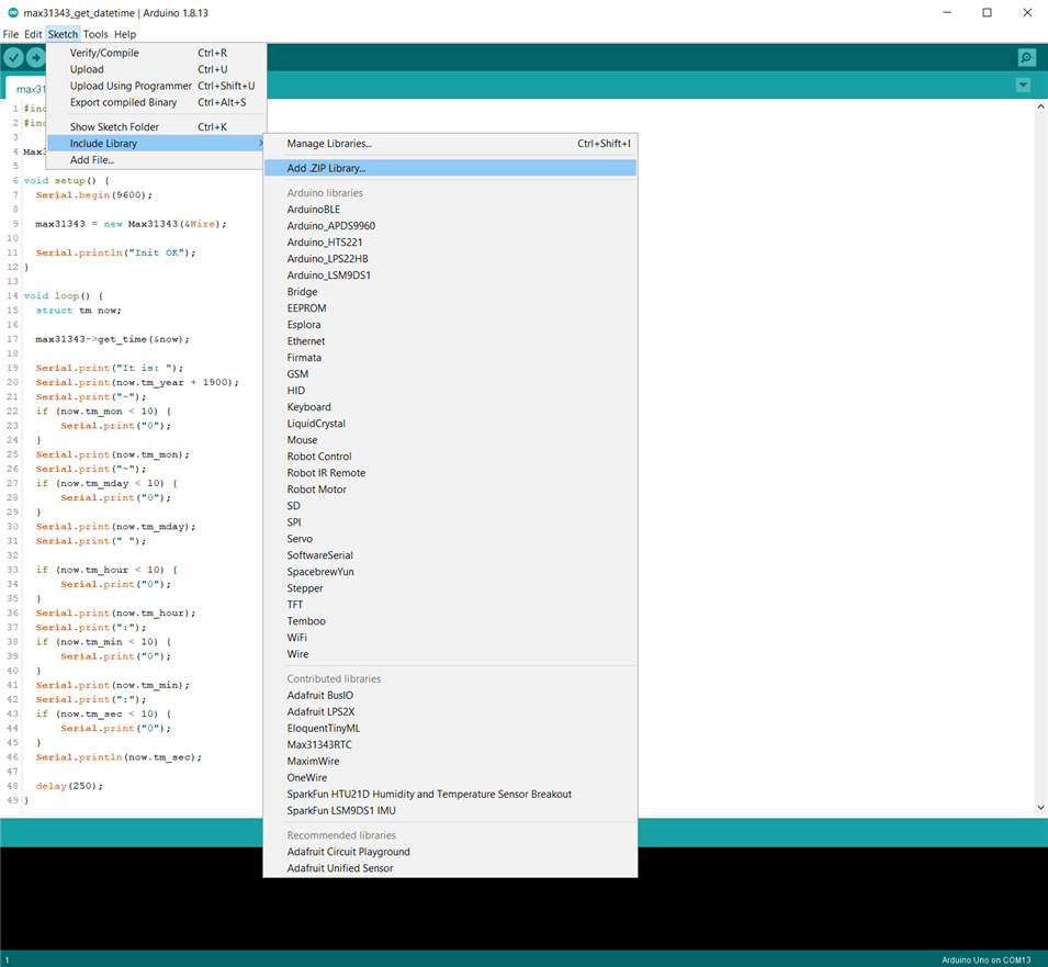

Library

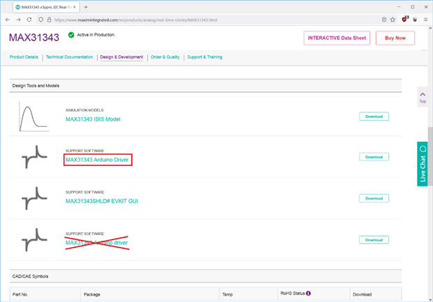

Go to MAX31343 page on Maxim Website and download library. Note that there are two similarly named files. Download file with uppercase D in Driver word. Library with lowercase D is older version with missing metadata for Arduino IDE and some bugs.

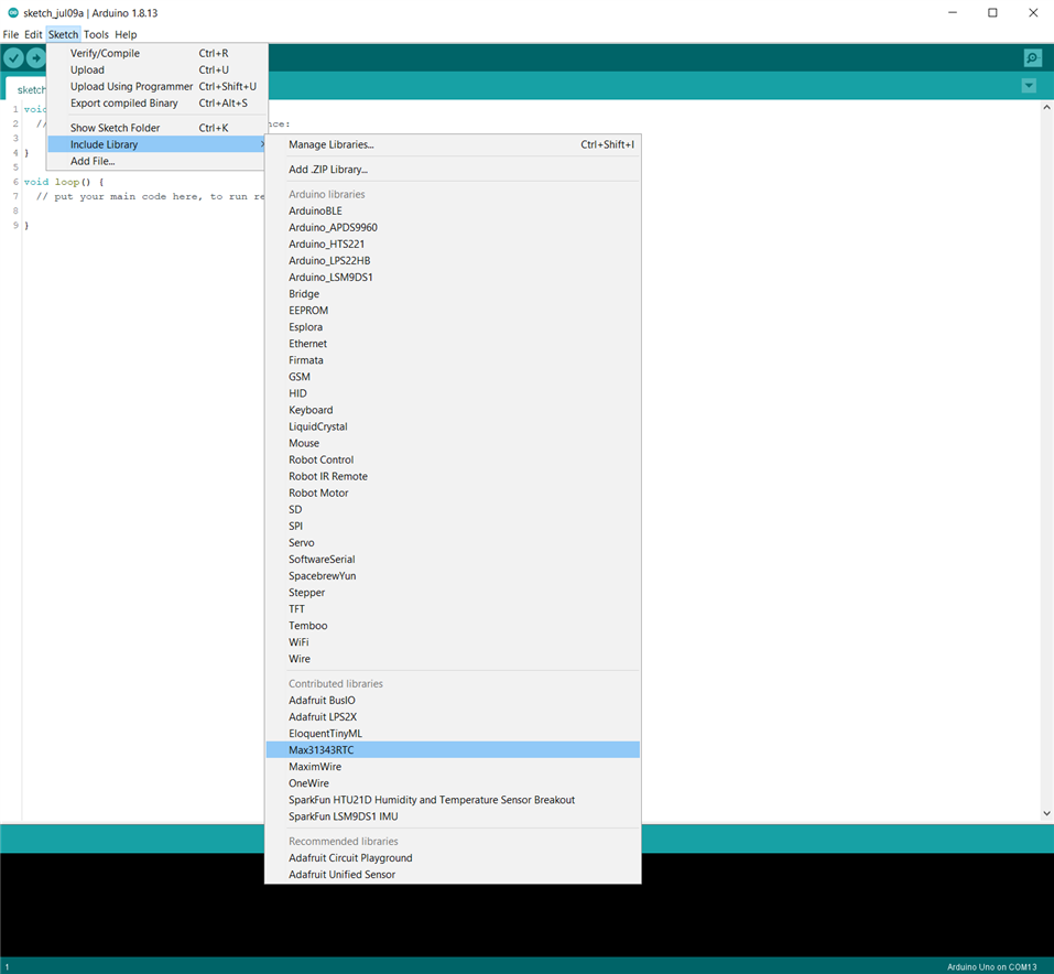

Install downloaded library to Arduino IDE using Sketch > Include Library > Add .ZIP Library….
Then you can include it into your sketch using Sketch > Include Library > Max31343RTC.

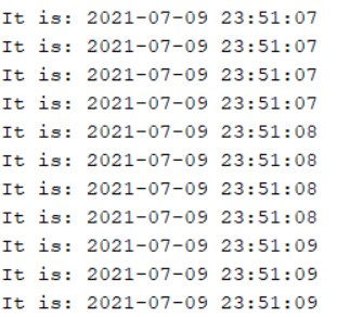

You can run your code and you should see time from RTC chip printed approximately 4 times per second. If you see incorrect time you need to modify your sketch by calling set_time method or you can disconnect your shield from Arduino, connect PICO board again and configure time using provided GUI software which you can download at the same page where you have downloaded Arduino library.

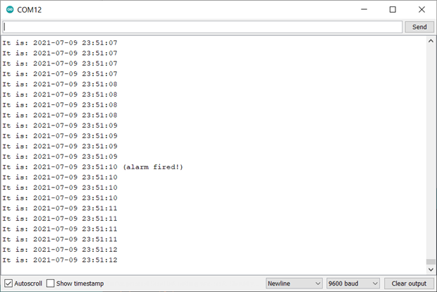

That is all. You can run your code. It will print 4 times per second actual clock and every hour at 51 minute and 10 second it will print information that alarm was triggered.
