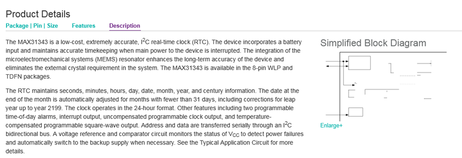

Most of things what I have said about PDF datasheets also apply for website. Some Maxim chips have simple block diagram drawn using black lines on white background, some of them have modern diagram paint in corporate colours. I originally thought that modern design is newer but for some reason they mix designs even at pages of chips referred on New products page. At the time of writing this text, block diagram shown on page of MAX31343 chip is broken:
The good thing about MAX31343 page is that it is complete. I found all documentation and software related to this chip here. Only missing information there is explanation of star note in price column.
I also missing some comparison with other chips. It is very hard to determine what are differences between at least chips with similar names like MAX31341, MAX31342 and MAX31343. Vendors usually provides some tables highlighting main differences between their models in one family. In fact, I did not find any common properties of them except all of them are RTC chip. After looking to their datasheets, I felt like they were designed totally independently and possibly by different teams. I found some similarities between MAX31341 and MAX31342 which look like partially registry compatible but for example alarm registers addresses do not match. Register map of 31343 is completely different. Migration possibilities are very low and mostly you will need to rewrite your software.
