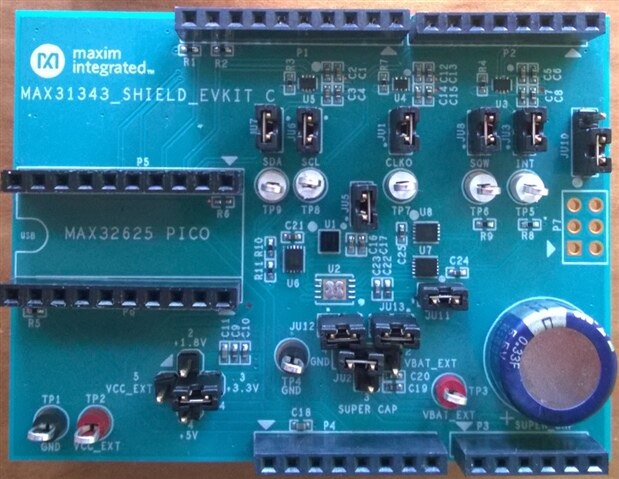

I welcome you to reading my review about Maxim Integrated MAX31343 evaluation shield. Shield is used for evaluating MAX31343 Real Time Clock (RTC) chip from Maxim Integrated. As part of shield there is connector for MAX32625PICO board which is bundled with shield. This board is used for evaluating features of RTC chip without need for any external programming using provided software. In this review I point multiple aspects about shield, RTC chip, microcontroller on PICO board, available development environment, available software, documentation, and some other aspects. This review is separated to multiple blog post presented in following table of contents. There are three kinds of article – tutorial, project, and review. Tutorial is written as detailed step by step tutorial which show how to use this Shield and RTC chip in some way. Projects show and describe projects which I have done for testing purposes. Review chapters describe aspects of board and contains my thoughts about this board and related parts.

The main chapters of review start with text “Review” in name. There are 3 these chapters. First of them is chapter “Review of RTC chip” and focus on MAX31343 chip. Second chapter “Review of Evaluation Shield” describes evaluation shield itself and finally third chapter “Review of MAX32625 Microcontroller and MAX32625PICO board” describes in detail bundled PICO board and it’s MCU. Following image highlights parts that are covered by chapters of my review.

MAX31343SHLD is nice shield evaluating very good RTC chip with very good performance. Evaluation shield is designed in very flexible way allowing you use this RTC chip in almost any configuration. Concept of allowing evaluating chips using GUI software and USB-to-I2C bridge provided by PICO board is good and I like it very much. Only disadvantage should be price which I consider high even when considered that shield is evaluating high-end RTC chip and there are some expensive components like supercapacitor.

  • Fully assembled (really no soldering or other mechanical operations needed)
  • Test points for every signal and power supply (easy oscilloscope/logic analyser connection)
  • Voltage level converters on each signal allowing set chip Vcc differently on logic signal levels
  • Jumpers for disconnecting any signal
  • Possibility to evaluate all powering modes and power sources
  • Supercapacitor
  • Pin description only from bottom side
  • IOREF vs 1V8
  • No possibility to use Arduino and PICO board at the same time
  • Price
9/10
