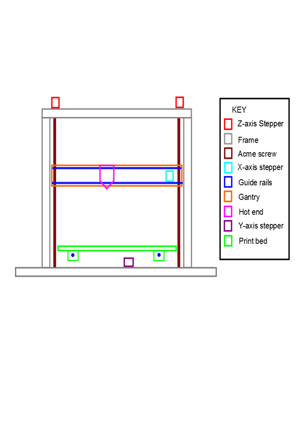

    So which arduino and RAMPS combo should I use... Like I said in my original post I have no experience with arduinos... So I know Nothing about which I should use
    Here is a extremely basic 2d drawing of what i plan to build

    hawkeyethehacker over 12 years ago in reply to e14 Contributor
    A comment is that the two steppers on one belt was listed as a major design fault in the Prusa Mendel.
    It may be easier to use a single stepper with a tension belt system to avoid the pains in alignment, maintenance and the case of where you need to manually move the Z axis (for example, if it jams)
