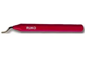

Deburring Tool
Many 3D prints end up with small pieces of protruding plastic that have to be cleaned up. A deburring tool makes the process easier, and with less chance of screwing up and destroying your print. Deburring tools are especially good for cleaning up modeled holes.
Ruko Deburring Tool

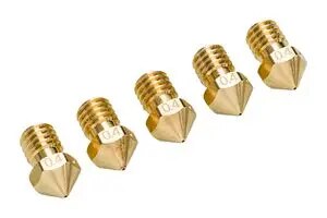

Different-sized Nozzles
Grab a vriety of nozzles for your 3D printer. Larger ones can print faster at the expense of resolution. Smaller ones can print with more detail, but are slower.
This example works with Ultimaker 3D printers.
0.4mm
0.4mm Nozzles

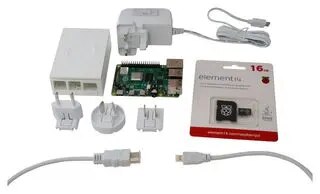

Raspberry Pi to run OctoPrint.
OctoPrint (https://octoprint.org) is software that can control and monitor every aspect of your 3D printer from within a browser. You can do things like viewing a webcam feed of your print, monitor temperatures, or start/stop/pause the current print job. It's completely free. OctoPrint is also open source, and there are already a bunch of plugins from 3rd party developers available for it.
Raspberry Pi 4 Starter Kit
