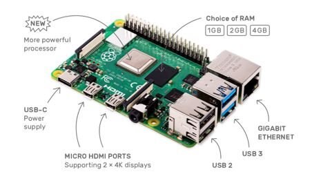

The RPi 4 is armed with a Broadcom BCM2711, quad-core Cortex-A72 (Arm v8) 64-bit SoC @ 1.5GHz having a Video core VI GPU managing all graphical input/output is supporting OpenGL ES 3.x and 4Kp60 hardware decode of HEVC video. It supports Dual monitor with 4K resolution along with H.265 video and also video scaling, camera input, with all HDMI and the composite video outputs. RPi 4  comes with Gigabit Ethernet, and it supports Bluetooth Low Energy 5.0 and Dual-band 802.11ac wireless networking. Click this element14 community link to expore more features: Raspberry Pi
The RPi 4 finds wide use among makers and hobbyists due to manufacturer technical support and the community ecosystem, which follows the purchase. Its performance makes an useful proposition for those embedded engineers who wish to develop consumer-grade IoT products, and ML inferencing on the edge.
DL algorithms are computationally expensive- a big problem for the resource-constrained RPi. Additional hardware is a must to run these computationally intense algorithms on the RPi.  The Intel Movidius NCS and Coral USB Accelerator imports powerful ML inferencing capabilities to existing Linux systems. These are powerful but small USB Accelerators derived from an ASIC based design. Such devices are “coprocessors” designed to augment primary CPU capabilities. Using these accelerators results in significant performance changes. They combine with optimized libraries provided from both Google and Intel.

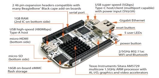

The Beaglebone AI board design caters exclusively to artificial AI workloads at the edge. The TI’s SoC AM5729 has dual-core Cortex-A15 processor embedding a dual-core C66x DSP, and 4 EVE (Embedded Vision Engine) cores, paired with a dual-core Arm Cortex M4 CPUs serve as an image-processing unit, generating maximum 8x performance per watt when running calculations for CV models compared to running on an Arm Cortex A15-based CPU. It also includes a dual-core PowerVR SGX544 3D GPU, Vivante GC320 Core 2D accelerator supports OpenGL ES 2.x for graphics applications.
The 3D GPU supports almost all general embedded applications. The GPU can simultaneously process different data types like general-purpose data, pixel data, video data, and vertex data.
A detailed technical specification can be read here: BeagleBoard
This SBC is aimed at developers who show an interest in experimenting with ML and CV. The user can access optimized hardware via the TI Deep Learning (DL) OpenCL API, which offers a "zero-download out-of-box software experience" with TI C66x DSP cores and embedded-vision-engine cores with pre-installed tools.
Most element14 community users prefer Tensor Flow, PyTorch, OpenCL, OpenCV  frameworks used for Beaglebone AI.

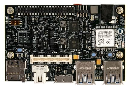

Ultra96Tm is an Arm-based, Xilinx Zynq UltraScale+Tm MPSoC development board based on the Linaro 96Boards specification, which integrates an Arm multicore, multiprocessing system with programmable logic that can be used to complete hardware accelerate compute-intensive tasks. The 96Boards’ specifications are open and define a standard board layout for development platforms.  This can be used by software applications, hardware devices, kernel, and system software developers. Ultra96 represents a unique position by supporting a wide range of potential peripherals and acceleration engines in programmable logic.
The Zynq UltraScale+ MPSoC ZU3EG device is fitted with Quad-core Arm Cortex-A53 MPCore with CoreSight as an Application Processing Unit and Dual-core Arm Cortex-R5 with CoreSight Real-Time Processing Unit, Arm MaliTm-400 MP2 as a GPU. The Ultra96-V2 board comes 2GB LPDDR4 RAM, a 16GB microSD card, Wireless options include 802.11b/g/n Wi-Fi and Bluetooth 5 Low Energy. Click this element14 community link to expore more features: Introducing Ultra96-V2
There are options to connect the Ultra96-V2 via a webserver utilizing integrated wireless access point capability.  The PetaLinux desktop environment is an alternative, with the latter, viewed on (if needed) the integrated Mini DisplayPort video output. It supports compatible low-speed and high-speed expansion connectors by the addition of peripheral accessories like the MikroE Click Mezzanine for 96Boards.
Ultra96-V2 runs PetaLinux off a micro SD card and targets AI, ML, IoT/Cloud connectivity for add-on sensors, embedded computing, robotics, entry-level Zynq UltraScale+ MPSoC development, as well as training, prototyping and proof-of-concept demos.
