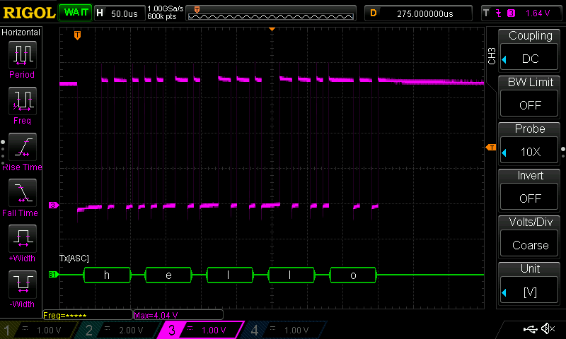

    Jan Cumps over 1 year ago in reply to beacon_dave
    I tried ChatGPT. First I used the above trace, without the green decode. I informed it was UART, 115200. It didn't get it.
    Then I told it was "hello". GPT couldn't trace it back to "hello"
    Then uploaded the image with the scope decode, and it worked Slight smile

    shabaz over 1 year ago in reply to Jan Cumps
    Hehe possibly it could do it a different way, perhaps write some code to convert from a supplied cropped image, to convert that purple stream into values for feeding into a logic analyzer. I tried to make it do the reverse (easier), to show what 'hello' should look like. It was not bad, the result was correct as far as I can tell, although it struggled with making the text look readable, since it was squashed up:
    https://chatgpt.com/share/68c57f62-6b70-8004-bead-7c14772e6f3e
    Jan Cumps over 1 year ago in reply to shabaz
    It guessed that the data was in the magenta. But t originally tried to convert it into a graph with the amount of magenta per time. And derive payload from that.
    It never got anywhere, also not when I gave the outcome. It tried franticly though Slight smile.
    It would possibly be very good at showing how to decode it (e.g. what image processing steps to take) more than performing the decode from the image itself. For instance, any techniques to get rid of the noise, or to figure out the edges, and then somehow work out where to sample the bits.
