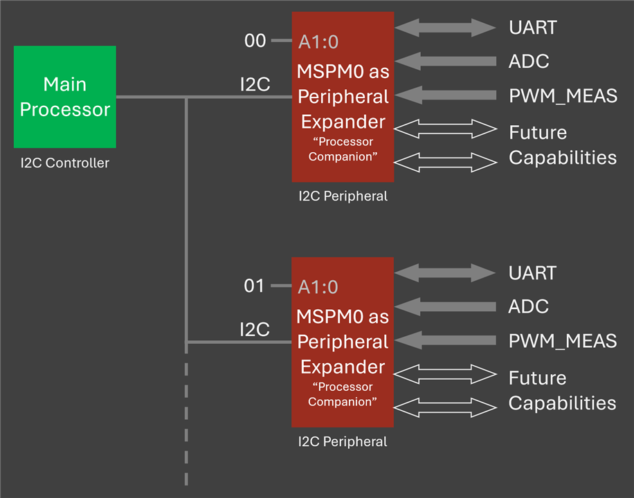

The MSPM0 microcontrollers are very low-cost, and friendly to use (lots of documentation and examples).  For a project, I was using an ESP32, but I ran out of UARTs!
Ordinarily I would have considered purchasing I2C to UART chips, but I'm not entirely sure how necessary the interface will be, and I'd rather not stock up on such specialist parts and then later realize they are surplus to requirements!

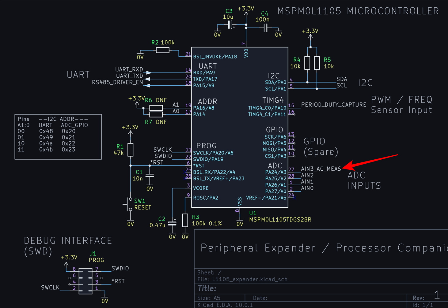

Instead, I decided to convert an MSPM0 chip into such a device (it's called a mspm0_i2c_periph_expander on GitHub). And added a few more features while I was at it.
The result is an I2C-controlled part which I can drop into some projects if I need a simple UART, or up to three channels of 12-bit ADC, or when I'm interfacing to PWM or frequency-output sensors, or if I want to measure AC voltage or current. It's simple and fast to program.

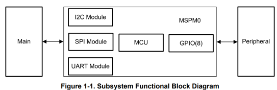

This isn't an original idea; the Beaglebone People use an MSPM0 on one of their boards, in a similar way (but not with UART). I used the older MSP430 microcontroller series as an I2C peripheral occasionally too.

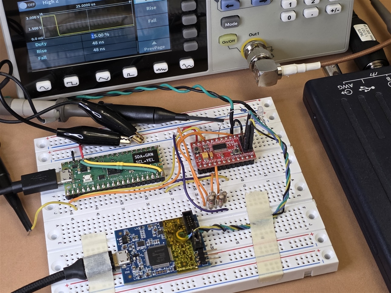

Testbed setup
Red = MSPM0 breakout board (miniL1105, documented here)
Green = Pi Pico acting as a (+) E-Z USB to I2C Adapter and UART Bridge - element14 Community
Blue = NXP MCU-Link Debug Probe
Oscilloscope: PicoScope 2000 series with PicoScope 7 software
Waveform Gen: Owon DGE1030 (although the PicoScope has one built-in too)

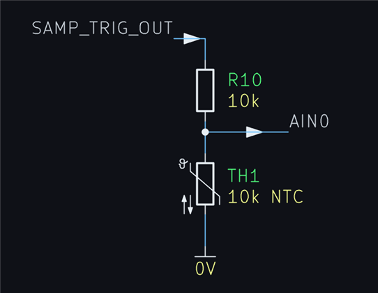

    I've been slowly (it's hot, hard to work!) improving this, there's now a small feature enhancement; for the ADC function, there is now an output pin called SAMP_TRIG_OUT which goes high whenever any of the three ADC inputs are being sampled.
    It's useful for NTC thermistor measurements (either used directly as shown here, or via a buffer/MOSFET):
    This saves energy, and also reduces thermistor self-heating. Temperature measurements are more accurate as a result. (Github repo updated).

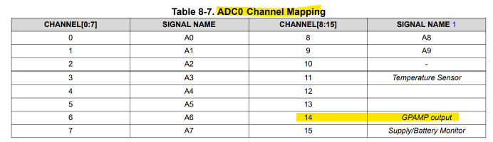

    The MSPM0 devices have 1 or more OpAmp on silicon. The L1105 has a generic amp, the L1306 has a programmable gain amp.
    For both devices, they can be internally chained to the ADC, and can serve as buffer, or DC offset generator to get the signal mid-range of the ADC...

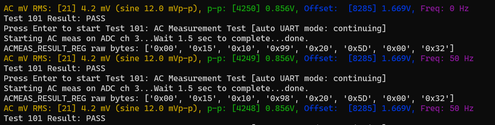

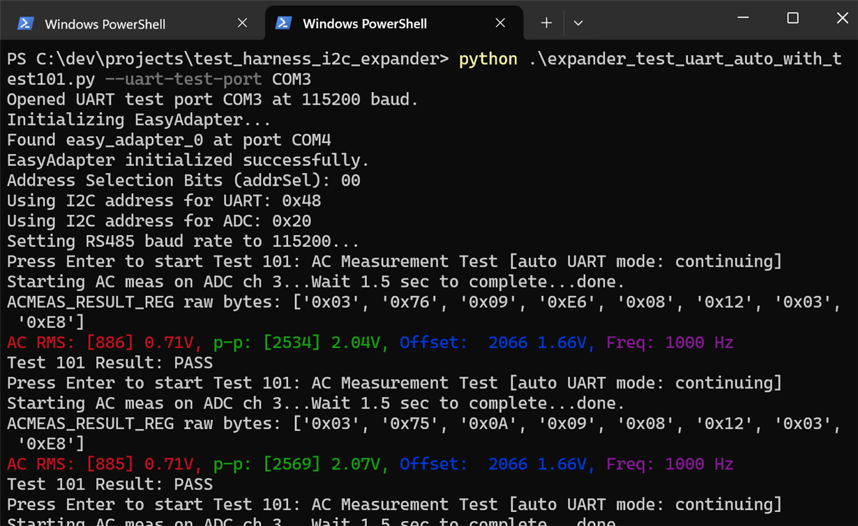

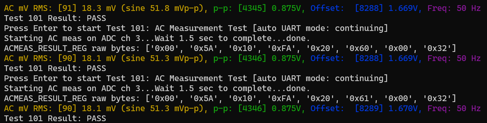

    I've updated the code on GitHub with some improvements.
    Thanks to a nice pointer from Jan Cumps  to check out this (+) 14 bit ADC oversample example for the EasyL1105 MSPM0 board - element14 Community I'm now getting 14-bit resolution.
    The frequency measurement seems to reliably detect 50/60Hz at around 10 mVp-p upward. The AC RMS seems very accurate too; I'm relying on the 3.3V from the testbed, which is generated from the Pi Pico, so it's just an informal test.
    10mVp-p sine wave input (not measured out of the sig-gen, so I don't expect that to be very accurate either):
    50mVp-p sine wave input:
    This will work great with a current transformer ((+) Monitoring Mains Current: Experimenting with the SCT013 Current Clamp - element14 Community). I've already tried that, and it can reliably measure the current from a LED desk-lamp (Sylvania 8W lamp) for instance.

    I gave it a shot, the results seem OK but I need to verify with some other signals. (I applied a 1 kHz sine wave, 2Vp-p 1.65V offset signal).
    The algorithm samples at 4ksps, for one second, all the while accumulating the sums of the ADC measurements, and also simultaneously the sum of the square of the ADC measurement. After the acquisition, the offset and RMS are calculated. The frequency measurement is experimental, I'm still working on it.
    To use this function, its best to examine the Python file in the test_harness folder, but in brief the steps are:
    I2C_write(0x20, ACMEAS_START_REG)  # 0x20 is the I2C device address, ACMEAS_START_REG is 0x50
    <wait at least one second>
    I2C_write(0x20, ACMEAS_RESULT_REG)  # 0x51 is the register ACMEAS_RESULT_REG
    I2C_read(0x20, 8)  # read 8 bytes, which are four 16-bit integers (first three are in ADC counts, last is freq in Hz)
    This is the circuit (red arrow indicates where to apply the signal-to-be-measured):
