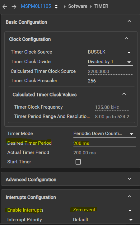

Framework: Timer
The timer logic is based on a TI example for this controller (see resources used). It fires an interrupt 5 times per second.

    // /* timer 5 interrupt ticks per second */
    // /* Enable Timer0 NVIC */
    NVIC_EnableIRQ(TIMER_0_INST_INT_IRQN);
    // /* Start Timer counting */
    DL_TimerG_startCounter(TIMER_0_INST);

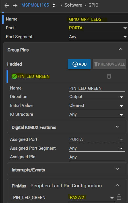

            DL_GPIO_setPins(GPIO_GRP_LEDS_PORT,
                GPIO_GRP_LEDS_PIN_LED_GREEN_PIN);

            DL_GPIO_clearPins(GPIO_GRP_LEDS_PORT,

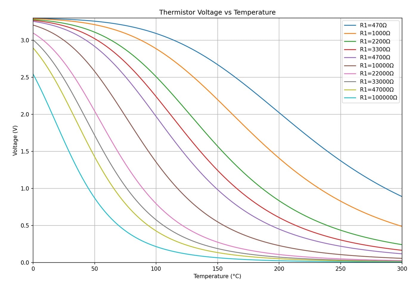

    I've been investigating the thermistor, and have tried this code, to simulate a potential divider with the thermistor at the bottom and a fixed resistance at the top, and currently assuming 3.3V as a reference:

    According to that, it looks like for the best performance in the 100-170 °C ballpark (where I think I need to be for the hot stamping to be effective), it is for a resistor of about 3.3k. Self-heating isn't too bad, should be less than a degree error which seems pretty reasonable.
