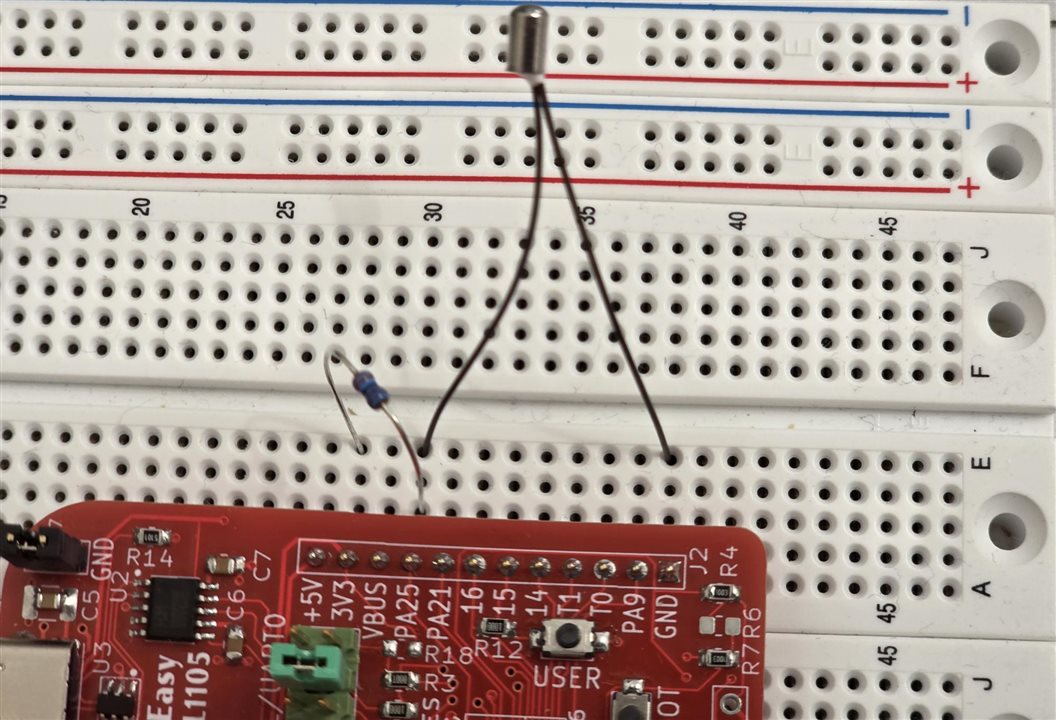

    Hi Jan,
    We think alike, I too tried the single conversion, in exactly the same way, with the minor difference that I averaged like in your 14-bit code earlier, except I went for 16-bit result, because I had written a thermistor potential divider to temperature conversion routine that expected a 16-bit value (in reality, even 12-bit precision is fine).
    The thermistor code assumes a 3.3k resistor to 3.3V, and the 100k thermistor to ground, and it exposes these functions:
    float adc_to_temperature(uint16_t adc_val);
    int32_t adc_to_temperature100(uint16_t adc_val);
    float adc_to_voltage(uint16_t adc_val, float vref);
    The top two of those functions convert a 16-bit ADC value into temperature, either as a float (e.g. 25.0), or as an integer in hundredths of a degree C, such as 2500 for 25.00 deg C). The last of those three functions isn't needed, but will convert the ADC value into the measured voltage.
    I've attached the project so far, based on your earler PID code. I also added in UART (based on another of your blog posts), but only in the TX direction from the MSPM0, to be used for debug output, since I suspect we will definitely need to see that while tuning the PID.

    This is the testbed (literally just the thermistor and 3.3k resistor as mentioned):
    When run, I see output like this (and it's plausible the temperature is about 23 deg C in this warm room):
