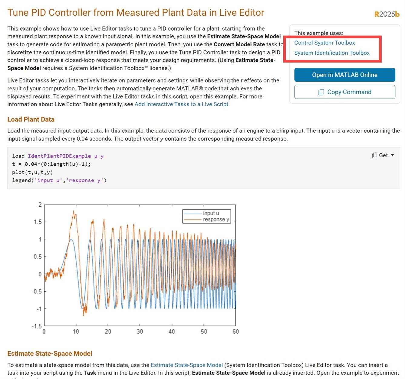

    This is great stuff. I'm impressed at how productive you both are here (for a part-time personal project). It looks pretty good to me for many purposes.
    I'm no control system expert (I don't have the practical experience to give good advice), but looking from the perspective of circuit feedback, I think the main complication is all the integrators in the loop. The low pass filter on the PWM is an integrator (at cutoff [10Hz, or so] the phase will be 45 degrees and move higher as you go up towards the PWM repetition rate of about 30Hz), any thermal mass on the output is an integrator sitting within the control loop [probably the dominant low pole, forcing the phase to 90 anywhere up near the PWM rate], and you have sampling and processing which will add other delays, so adding any more with the PID controller is going to make for a very fragile situation with, if not actual oscillation, a very poor phase margin. Since the main job of the PID integrator is to deal with the proportional term not being able to drive all the way to the set point [so as to mop up the very last bit of error], the 'hack' the AI has given you is to disable the I in all the other situations where there is enough gain to drive really embarrassing oscillation. It might be possible to tune the PID better - essentially the ID is a form of lag-lead compensation, so if you were to roughly model the load and the filter in electrical terms and draw a Bode plot of the open loop, you could maybe then see what was needed get a decent gain and phase margin - though I'm not sure how the sampled nature of the control and any latency is dealt with, and I'm not convinced a single D term can counter three integrators, can it?
    I don't know if this would work, but an alternative approach might be to turn off the PID I term entirely and dither the low bits of the set-point input (would need good random numbers with no DC offset, obviously), which might be enough to get the thermal mass integrator to the right point. Might be added complication for no real advantage though.
    Of course, if what you've got is good enough, stick with that. But if you want to develop it further, I think you are going to have to roughly model the 'mechanical' part of the loop [the 'plant'] and include it in your considerations.
