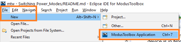

In the IDE, create a new project. File -> New -> ModusToolbox Application

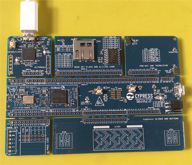

I'm using a PSoC 6 WiFi and Bluetooth prototype kit (I got this from balearicdynamics!).

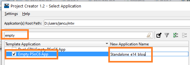

I use the "empty" project for this board as the base. I name it Standalone_e14_blog.
Then click Create.

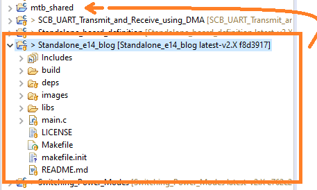

The result is a new project in the IDE.
It uses the shared configuration in the mtb_shared folder. If I reconfigure a device or the board file in my project now, my other project SCB_UART_Trans... would get the modification too.

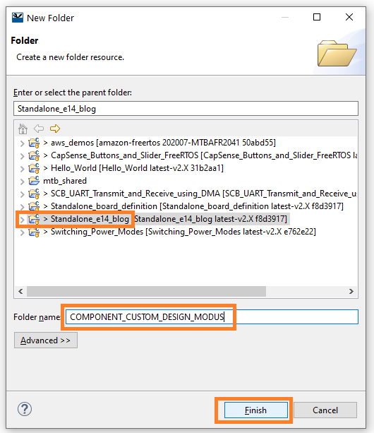

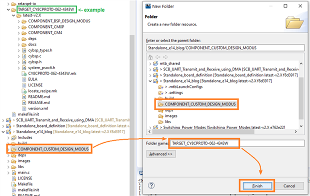

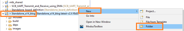

Create a directory named COMPONENT_CUSTOM_DESIGN_MODUS in the root of the new project.
Right click on Project -> New -> Folder
Enter COMPONENT_CUSTOM_DESIGN_MODUS and click Finish.

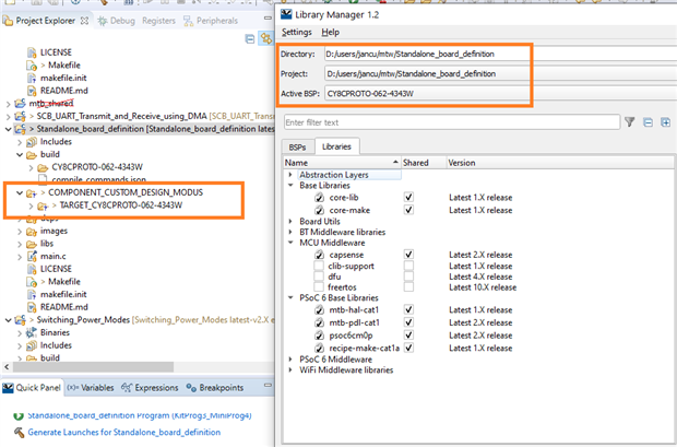

In that folder, create a subfolder with the structure . In my case TARGET_CY8CPROTO-062-4343W.
If you don't know what the name for your board should be, check the mtb_shared project. It will have a folder with the correct name for your board.

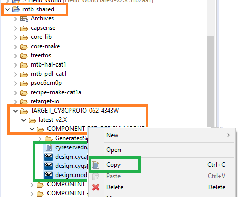

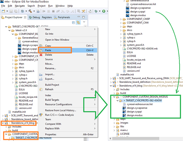

Then, I copy the necessary files into the new folder.
Copy everything from the mtb_shared / TARGET_XXXXXXXX_ / latest-vXXXX / COMPONENT_BSP_DESIGN_MODUS, except the GeneratedSource subfolder.
I paste the files in the custom folder structure of my freshly generated project:

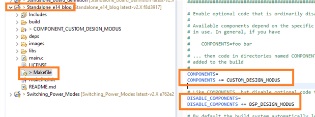

You need to add two lines to the makefile. It will tell the builder to look for our local configurations.
These two lines need to be added.
COMPONENTS += CUSTOM_DESIGN_MODUS
DISABLE_COMPONENTS += BSP_DESIGN_MODUS
Save the file.

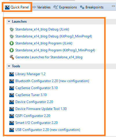

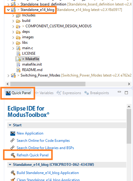

Last step: Refresh the Quick Panel
In the Quick Panel, click the Refresh Quick Panel hyperlink.
This is it. All tools will now use your local project configuration.

    • I tried this out and was confused at first because the Shared directory (mtb_shared / TARGET_XXXXXXXX_ / latest-vXXXX / COMPONENT_BSP_DESIGN_MODUS) for the BSP device was not listed as described in Step 2.
    • What I had to do was make the device  shared in the Library manager. It was unchecked by default. When I checked it and selected "Update", the directory was created. Now, I can follow along to the rest of the steps.
