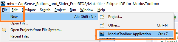

Start an empty project
File > New > ModusToolbox Application

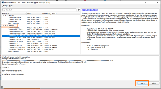

Select the PSoC empty project for your board:
I use the WiFi BT prototyping kit, so I selected that one. Press Next.

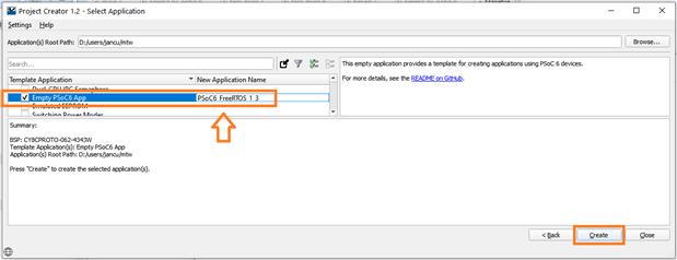

Look up and select the empty project. Rename it (I used PSoC6_FreeRTOS_10_3). Press Create.
Once the wizard generated the project, press Close and return to the IDE.

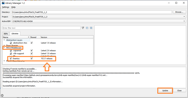

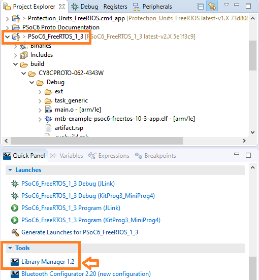

Add FreeRTOS 10.3
With the project active, select the Library Manager in the Quick Panel.
On the Libraries tab, select freertos, shared, and version 10.3.1 release (or the version you want to use).
Click Update, then Close when finished. Return to the IDE.

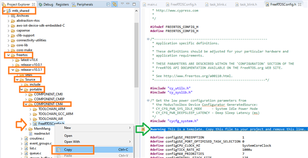

Then, add a FreeRTOSConfig.h file to your project. You do that by copying the one from the shared FreeRTOS area into your project:
Paste this in the root of your project.
Then open that copied file, and remove the "#warning This is a template. Copy this file to your project and remove this line" line.
As last step in the preparation, add this to the include section of your main.c file:
#include "FreeRTOS.h"

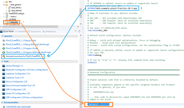

Edit the Make file
Now a step that was not needed for the rtos version 10.1xxx. But if you don't do it for 10.3, your build will fail:
Open the Makefile by double-clicking it. You find it in the root of your project.
Update the COMPONENTS section:
COMPONENTS=FREERTOS
Now that we are in the make file, let's also change the name of the output file. It's called mtb-example-psoc6-empty-app by default. See the orange part of the image above.
APPNAME=mtb-example-psoc6-freertos-10-3-app
When you change the output file name, you need to update the execution configuration.
You do that by, after saving the make file,  clicking the Generate Launches option in the Quick Panel. See the blue part in the image.
This is a good time to do a first build. If it succeeds, you know you have a good start.

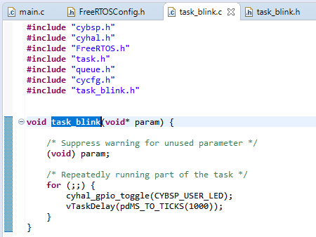

The Task
I will discuss the task first, and then the activities to configure the LED and schedule the task.
void task_blink(void* param) {
  /* Suppress warning for unused parameter */
  (void) param;
  /* Repeatedly running part of the task */
  for (;;) {
    cyhal_gpio_toggle(CYBSP_USER_LED);
    vTaskDelay(pdMS_TO_TICKS(1000));
The task is very simple. A LED is toggled, and the task yields to the RTOS scheduler for one second. In an ever lasting loop.
The effect is that the led will blink every 2 seconds:
  • LED toggle
  • yield for a second
During the Delay, the task is inactive and the scheduler can execute other tasks.
This is different to delay mechanisms that use MCU ticks to burn time. Those occupy the MCU for a second. The FreeRTOS vTaskDelay() task frees the MCU for a second.
I've put the task in a separate header and source file:

task_blink.c
#include "cybsp.h"
#include "cyhal.h"
#include "cycfg.h"
#include "task_blink.h"
  (void) param;
  for (;;) {
