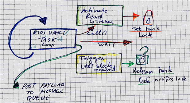

The steps to integrate incoming UART data with FreeRTOS on a PSoC 6.
The focus is on saving processor power. The design does not poll for incoming data.
It yields all powers to the RTOS scheduler (possibly going to low power mode) until a trigger fires after a defined number of bites arrived at the UART input.

The design has a FreeRTOS task that patiently waits on a notification. The code above in the interrupt is the code that generates that notification.
It fires exactly at the right time: when the agreed number of bytes are available and have been moved to the read buffer.
What happens is:
  • the default interrupt processing for the PSoC 6 is done at line 03.
  • We ask FreeRTOS to notify the waiting task that the agreed bytes have been received, at line 10.
  • Then we inform FreeRTOS that our interrupt handler has finished.
