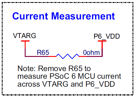

Cypress provides a solution for current measurement on the PSoC6 prototyping kit.

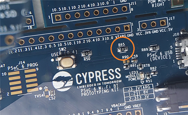

If you remove R65, a 0 Ohm resistor, you can put a DC current meter  in its place.
You can then log the measurements and analyse them.

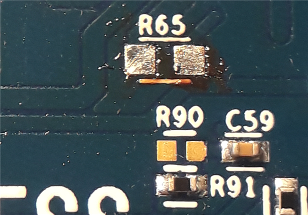

R65 is easy to remove. There are no sensitive components near it. I used a hot air pencil.
In case you want to put it back later, tape it for safekeeping in the inside of the kit's box.
Here is the result after wicking remaining solder from the pads.

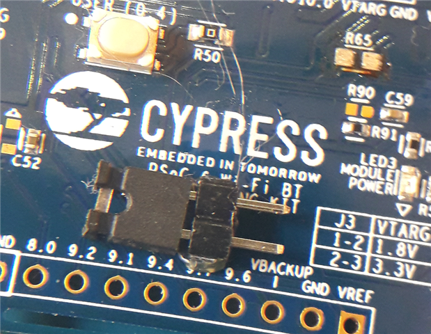

I want to have a replacement that makes it easy to put a meter in the circuit. Also to make it easy to bypass if I'm not measuring.
I'm using a male pcb header for that. When not measuring, I can put a jumper on it. When measuring, I can make a little cable with female pcb headers.
I used a tiny drop of hot glue to fix the header on the pcb. I glued it without the jumper in place to avoid that it gets stuck there.

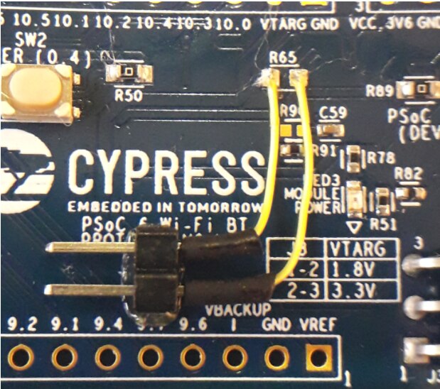

Then I soldered two thin wires from header pins to the pads of R65. A little crimp sleeve isolates the 2 pins.

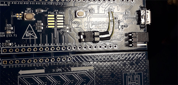

That's it. The board is now ready for energy profiling.
