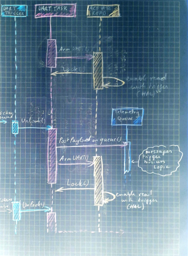

The steps to use an RTOS message queue to exchange data between tasks. In this post, we post data from the low level hardware (UART peripheral) to a task that handles a logic part of our firmware.
This is a direct follow up from the previous FreeRTOS post, where semaphores and triggers were used to collect incoming UART data without burning CPU cycles.
Now, we add the mechanism to give that data to the logic part of the application, while keeping the UART / low-level part lean.
We'll use message queues for that. One of the common RTOS mechanisms to give away data and continue with core business.

Using a Message Queue to send data to a task
In this post I focus on a few of the advantages:
  • keep the UART handling as lean and reactive as possible
  • isolation between hardware (UART) and logic
  • buffering to deal with peak loads without losing serial data
The first one is fairly easy. When you have a queue set up, the UART handler just has to put the received data on it, and continue with its business to handle incoming data.
This is executed right after the UART trigger woke op our FreeRTOS task:

At this point. The UART part of our code forgets about that data. It is pushed onto the queue. It is now a job for the business logic to eat that queue data.
The mechanism of reading the data off the queue is similar to a trigger. Our receiving task will not consume any CPU, unless a message was pushed onto the queue it is waiting for.

Again very simple. The task is a loop that does not continuously burn clock ticks.
It has a guard condition: a message should be available on the queue it's watching.
Once a message arrives on the queue, the task wakes up and takes that message.
In our scenario here, that is the same data that was received on the UART port from previous post.
We can then process that message.
