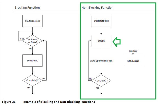

image source: Infineon application note AN219528 PSoC 6 MCU Low-Power Modes and Power Reduction Techniques

The controller supports a number of power modes. In the high power modes, all peripherals can be fully operational and reactive.
But even though the serial blocks support several low power modes, there are consequences.
Everything above deep sleep doesn't need your attention. The block and controller are awake enough to deal with serial data.
Once you go to deep sleep, the situation becomes different. Sending is disabled - and that's normal: we are trying to do as little as possible in deep sleep.
Receiving data with interrupt still works. It is one of the valid wake-up triggers. But you need to prepare the UART block.

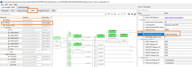

  • the FreeRTOS configuration. We used the AnyCloud MQTT Client example as base and that supports deep sleep.
    I had altered it to disable that functionality. I've now reverted to the original example's version.
