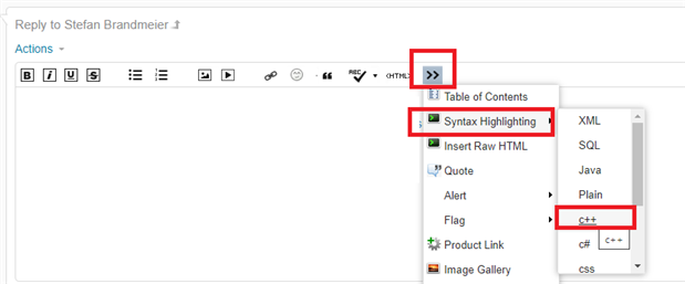

    (tip: when you post code on the blog here, there is a function to make it more readable.
    Paste the code, select it, then use the >> button to select Syntax highlighting -> C++)
