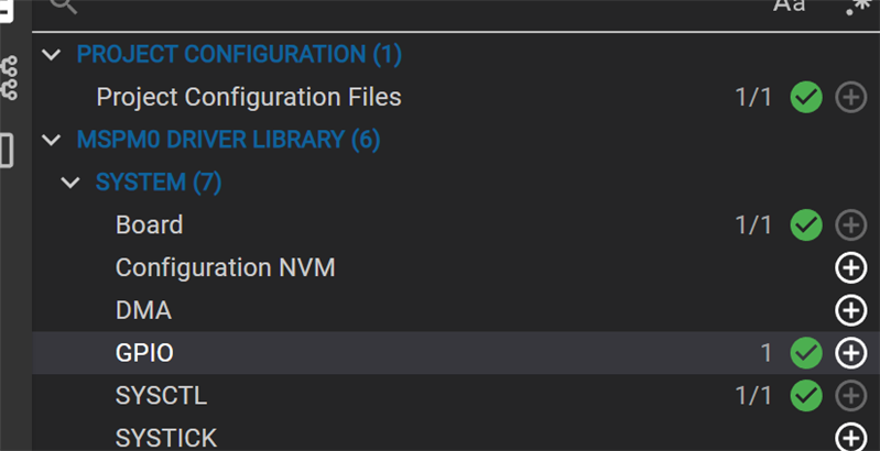

Press CREATE. ccstudio will now download the MSPM0 SDK for you. When all is done, the project opens in the configurator view:
The controller type is correct. Just change the package to VSSOP-28(DGS28) via the SWITCH button.
We don't need to change anything else. We 'll use GPIO only, and that's already enabled by default in the config.

    Jan Cumps over 1 year ago in reply to shabaz
    It looks the same inside ccstudio. It was there without me requiring to install SysConfig.
    When I created an example with the wizard, Board was selected by default. I didn't have to change anything to get a "do nothing" design working. Just Build then Debug.
