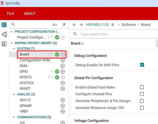

    The SDK that got downloaded contains an example folder, although for different MSPM0 parts, but still interesting to explore. Also it could be maybe worth checking out the SysConfig tool to see how any arbitrary integrated peripherals are configured, since it will generate the C code for that, which can then be inspected and copy-pasted, or the generated files used directly. I've only briefly tried it so far.
    I downloaded the standalone version of SysConfig, but I'm guessing it is also embedded in CCStudio), and key tip, is to select "Board". I wasted a very long time not realizing that! : )
