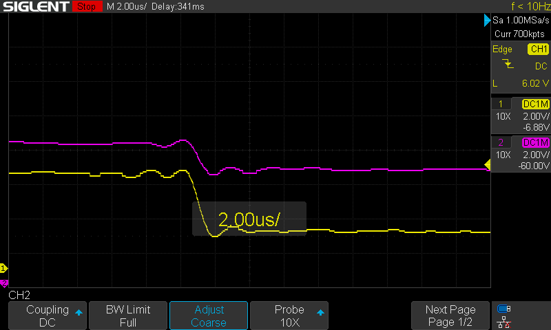

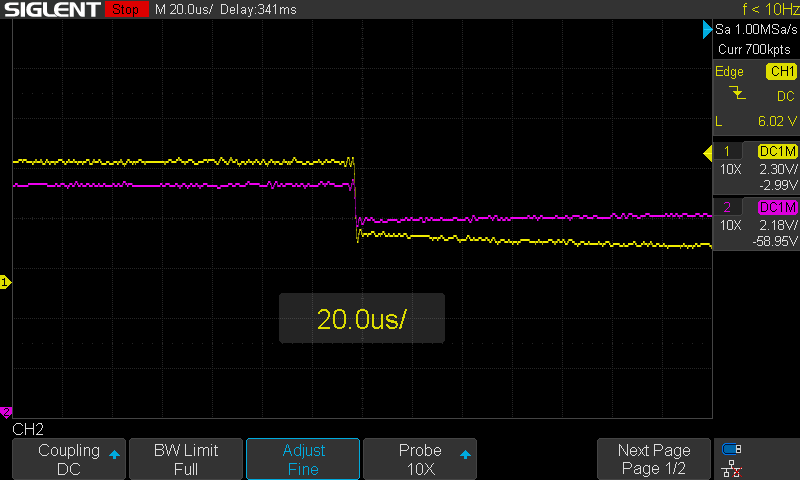

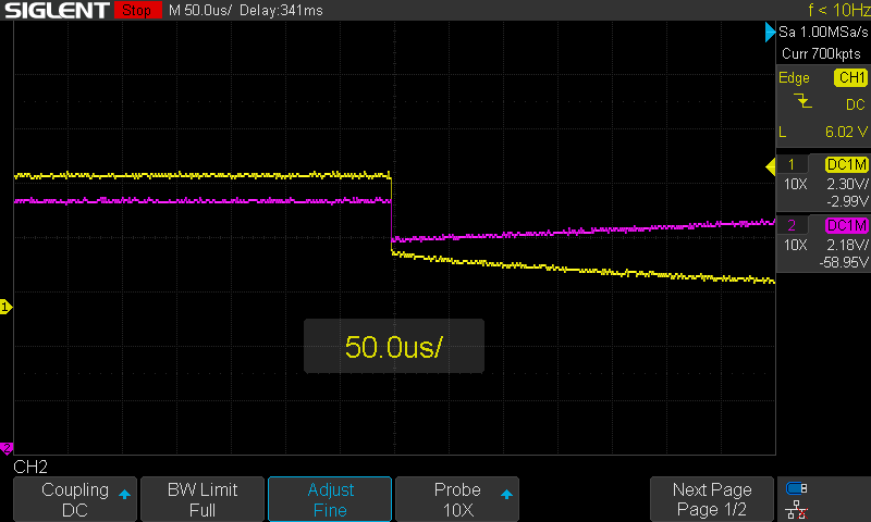

    Ok, clock yellow, triggered on falling edge. Pink is D / ~Q. 500ns is the limit on this scope.....
    0 dougw over 5 years ago in reply to opalko
    Can you show The rising edge of the clock and the D input at maximum time resolution?
    When the clock edge is detected at about 2 V the value of D gets latched to Q.
    If D changes after that, and it will because /Q will change, it will not change Q.
    You want to look at the voltage at D when the clock is first recognized as going high.

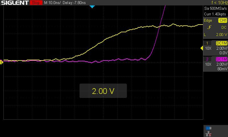

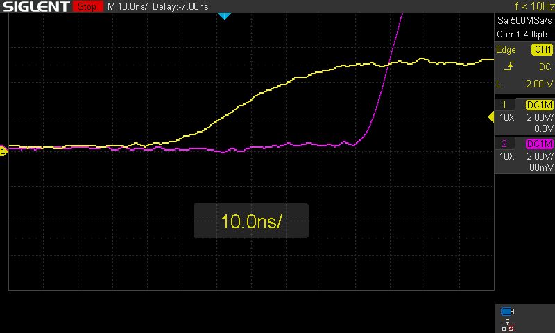

    Ok I hope this is correct. Yellow clock, pink D.  I have a long way to go learning how to use my scope image
  • opalko
    0 opalko over 5 years ago in reply to opalko
    If nothing else I am learning to use my scope better (I think). I was wrong about the limit, here is 10ns... I haven’t figured out why I don’t see D climbing when clock is at 2V; I know I still have scope settings wrong somewhere..
    Thank you for the answers and putting up with my ignorance on this stuff!
    That is a good scope shot. It shows that D is stable and low when the clock goes high.
    This latches low on Q and high on /Q.
    When /Q goes high, D goes high, because they are connected.
    Because there is no rising clock edge after D goes high, Q stays low.
    The delay between when the clock goes high and when D goes high is the propagation delay through the FF.
    If you capture what happens when D is high and a rising clock happens, D should stay high until after the clock goes high and then go low after about the same propagation delay..
