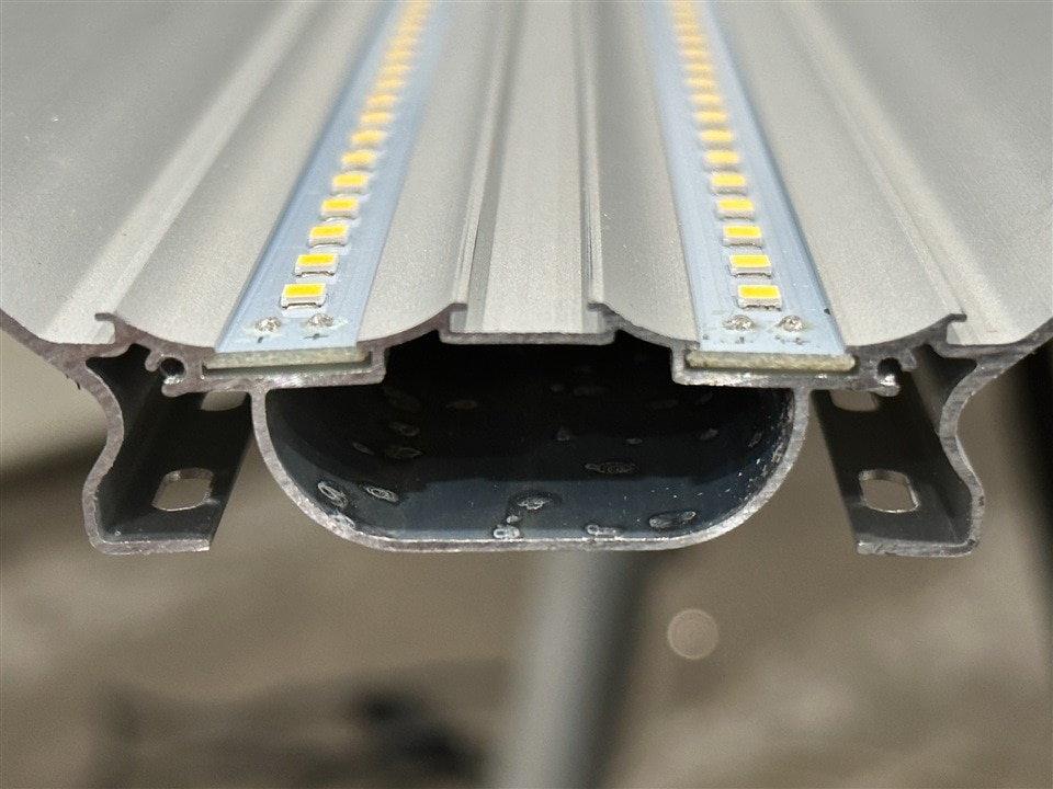

On my (actual) workbenches, I have overhead LED light bars. I'm very happy with the amount of light they provide. However, their color temperature is warmer than I like. Their temperature is especially annoying when doing video/photo work because it makes everything look gross. (I waste a lot of time color-correcting videos from my bench!)
I'd like to replace the LEDs to get 5700K-6000K lights instead.
First, I checked to see if Global Industrial has another color, but they only sell 4000K lights in this configuration. Bummer.

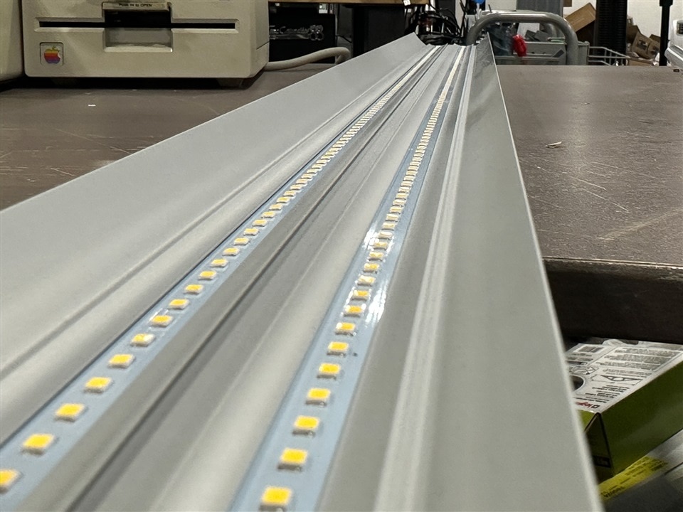

I took one light bar apart. There are two LED strips inside, each operating off of 45 VDC. There are 135 LEDs on each with a 2835 package size. Doing some clever (lol) measurements, I found there are 15 LEDs in series, and 9 of those groups are in parallel. (There are +/- terminals at either end of the strips.)
Turns out, the description part number spells all of that out: 18c-15x9(2835)1171-v2b. So much for my clever measurements.
Edge of Global Industrial LED Light Bar

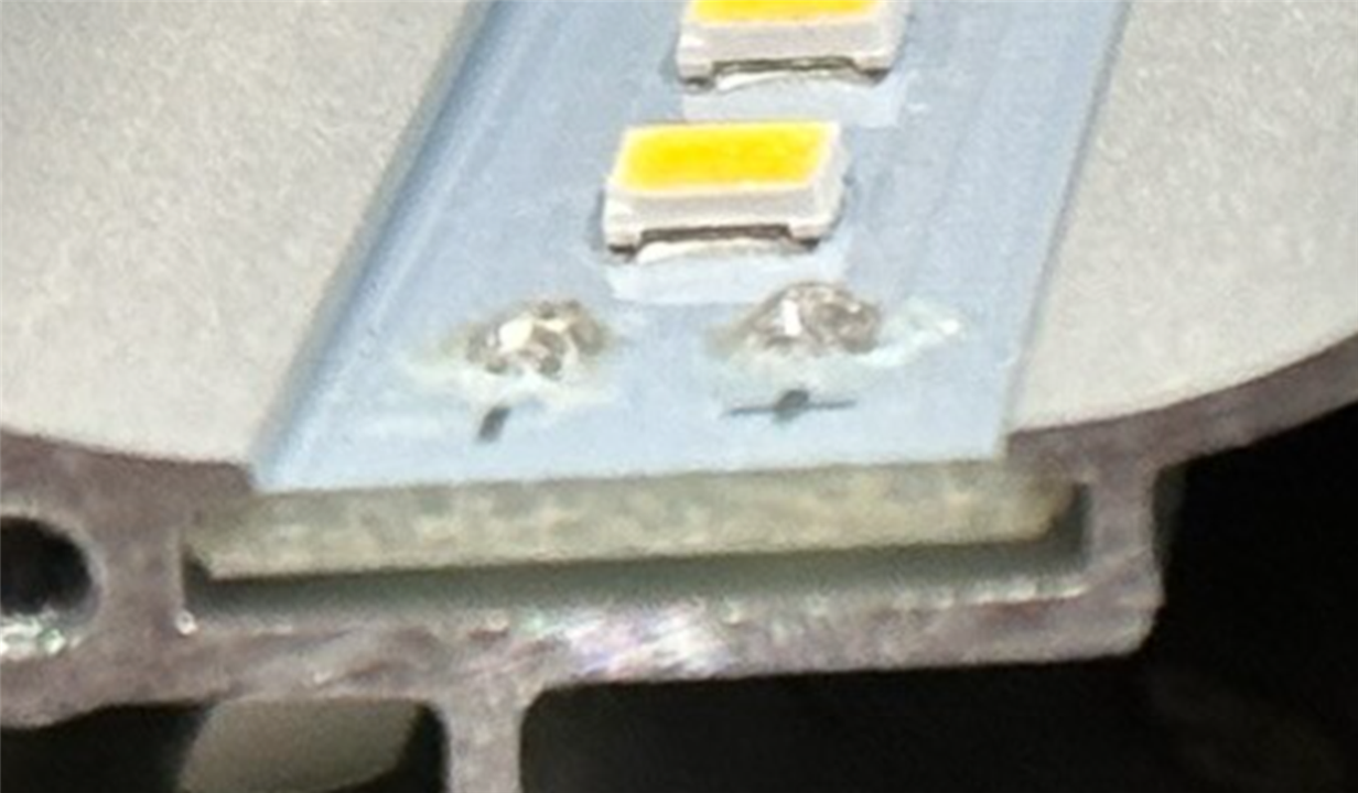

I'm not convinced that the LEDs are soldered to an aluminum substrate.
Will this work?
So here is what I'm thinking: replace the SMD LEDs. The strips only have two wire connections to the supply. So removing them from the (aluminum?) enclosure should be relatively easy.
My plan is to use a hot plate to pre-heat a small section of the strip and hot air to hit reflow. This should allow me to remove and re-install LEDs. Quickly, right?
But. Am I overlooking something? Is there a reason the soldering won't go well? Or is there another way to approach this problem?
I did consider just using generic "LED Strips." But they all seem to operate off of 12 Vdc. I'm not in the mood to re-design the supply section.
What do you all think? Any other ideas or concerns I should consider?

    That's a long way to go to get the right colour temperature - and then again, maybe it's also worth paying attention to CRI as well. It will probably work assuming all is well, but prolonged heat will soften/char the FR4 substrate and doing it in sections may cause warpage that may potentially affect the connection reliability (because the "shape" of the PCB is changing due to differential heating/cooling).
    An optical filter may be possible - but you will cut down on the light quite a bit using something like a cool filter. Camera custom white balancing with a grey card generally works as long as you don't then have something active (e.g. an LCD screen) in shot that has its own colour temperature.

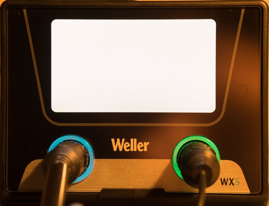

    Well, with custom white balance, I set it once for the light I'm using and then it's kept as a setting on the camera. Otherwise, I use white balance corrections in post (in a way, similar to Auto Colour in Premiere Pro).
    Unfortunately, this becomes very problematic when LCD screens are around since many are backlit at about 6500K, so if I correct for my 2700K source, it looks horrible. Alternatively, correcting for the screen means the background is horrible.
    (White balance corrected for LCD, but room lighting 2700K makes everything look orange)
    (Room lit by 2700K source as above, but since no active source of light at any other colour temperature, I custom white balance adjusted on the grey ESD mat and all looks well)

    To expand on my other response, the complication is that the temperature difference between the overhead (spot) and other lights (key/fill) cause a lot of color correction problems. I know most people don't catch it, but it is something I see. E.g., a breadboard's white is completely different from an instrument's front panel white. So I have to either do a bunch of masking or pick an in between.
    But more than that, everything in my lab is very cool white, except the work benches. So even outside of videography, I don't like the temp.
    CRI is something I had not given much attention to before, so I'm quickly understanding how that plays a role!

    It looks like it might just be FR4, so that should work to remove the LEDs and attach new ones.

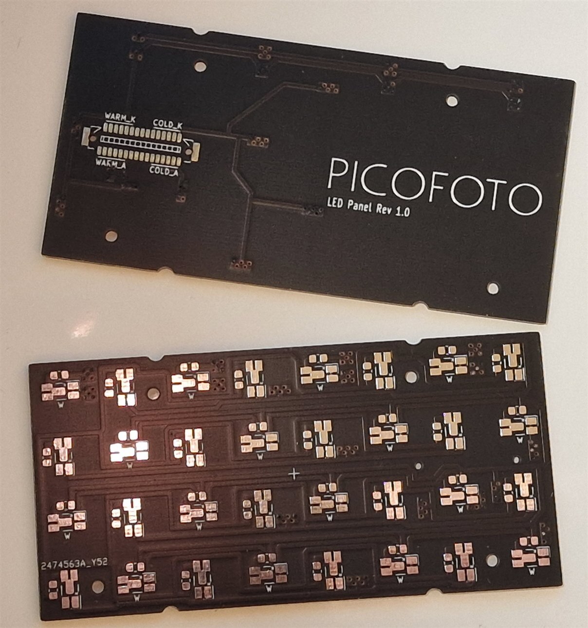

    I tried to make my own LED board too (out of FR4). I had to pause to work on a RoadTest, so it's been in limbo but I should try to solder the LEDs at some point. I too am going to use a pre-heater and hot air tool, but I might use low-temp solder because I've never used hot air for LEDs before and I don't know that I trust myself with it too much. A reflow oven might be safer. I've procrastinated quite a bit, in part because I can't decide how to approach the soldering exercise.
    These panels are for warm and cold LEDs (its for this PicoChroma project I attempted at the start of the year).
