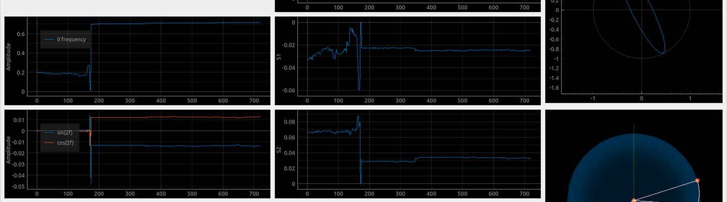

Using the polarimeter and some measurements.
To test everything I have assembled a simple mount that holds a diode laser with optics, followed by a Linear polarizer in a rotation mount. Finally, the polarimeter sensor measures the light transmitted by the polarizer.
To process data, I have written a program in Python which reads data from FPGA and then calculates the Stokes Parameters. The program is threaded such that data reads are done separately from the UI updates. This should prevent any overflowing of the serial buffers.
Data from the FPGA is plotted on the left side. Stokes parameters are plotted in the middle. Lastly, I am plotting the polarization ellipse on the top right. In the bottom right, a Poincare sphere is plotted. To use the program a horizontal reference polarization has to be set. This is done by shining a "reference" linear polarized light into the sensor and running the calibration.  During the calibration, 100 samples will be collected, which will be averaged and used to compute the values of θ and δ mentioned above.
In the image below we can see a measurement of linearly polarized light. You can also see the history while I was playing with the polarizer.
I have noticed, that If I was spinning the polarizer the S0 (or the intensity Stokes parameter) was changing. This is because the laser diode I used was emitting polarized light. And now that I have the tools, I could measure it.image
We can see, that the emitted light is elliptical. I also tried getting measurements of different light sources I had on hand. Also, keep in mind that the optical components inside the sensor used are meant for 850nm wavelength.
{gallery}Random measurements
Measured polarization of incandescent light. Small and noisy values S1, S2, and S3 are can be interpreted as unpolarized light.
Measured polarization of a phone flashlight. Light is unpolarized.
Measured polarization of a red laser pointer. Polarization is linear.
A note on result interpretation
Currently, the software draws a point on a fixed-size sphere and an ellipse with a fixed-size major axis. In the images above I added two examples of unpolarized light, incandescent and LED light. To know whether light is polarized or unpolarized can be determined using a "polarization" factor:
Using this we can evaluate values of p for measurements above:
Measurement value of p
Linear polarizer 0.400
Test laser 0.053
Incandescent light 0.012
LED 0.002
Red laser pointer 0.019
As can be seen, the LED is the least polarized, followed by the incandescent. We can see that the initial laser (OPV330, VCSEL technology) used for testing is much more polarized than the red laser pointer, which is probably due to the difference between laser cavities.
