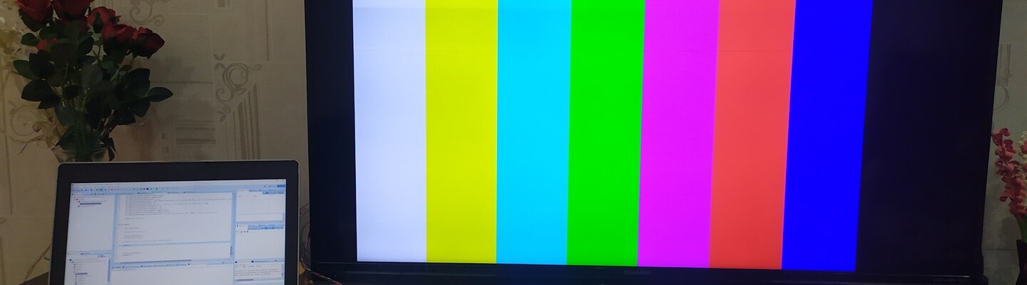

Now, all that was left was to connect this cable on one end to the "JA" PMOD, other end to the HDMI input of my TV, and compile and run the Vitis program that we created in the previous post.
In a few seconds, a 640x480/60Hz test pattern appeared on the screen.
Congratulations! We have just turned our Arty-S7 into an imaging capable system even though the board doesn't have any HDMI output port. THIS is the flexibility and power of FPGAs!
