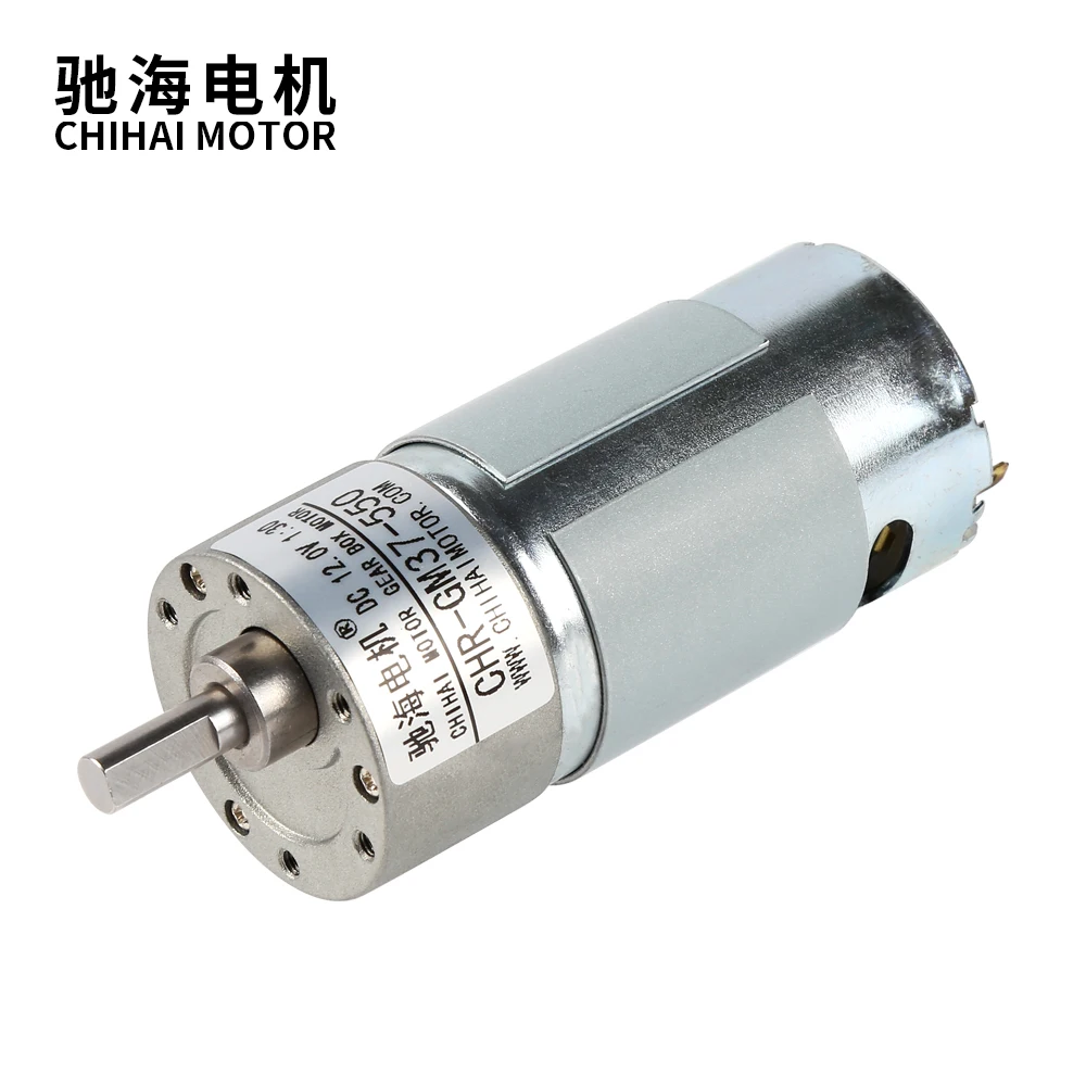

DC Motors
For the Arty-S7-ROVER I am using two CHIHAI GM37-550 DC motor with a gear ratio of 50:1 and 12Vdc with a maximum input power of 40W.
WarningThese motors are kind of powerful. I am using them as that is the chassis and hardware I already have from a previous project.
