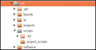

Repository File Structure
The Avnet git repository for Vivado projects contains the following subdirectories:
DirectoryDescription
boardsContains subfolders for each known SBC and SOM & carrier board combination.  Each SBC or SOM folder has a subfolder for design-specific sources (constraints and TCL scripts, etc.) for each design variation available.
ipContains subfolders of Avnet-created IP that is used in various designs.
projectsContains design-specific subfolders where the Vivado project will be built. This folder is ignored by git.
scriptsThis and project_scripts subfolder contain the board and design-specific TCL build scripts.
softwareDeprecated.  It isn't used by any of the current build scripts.  It is still part of the repository for legacy reasons.
This structure has been setup for maximum flexibility in design creation as well as maximum reuse of designs. Avnet has made a commitment to using this structure to implement our designs in order to give our customers a consistent look and feel to our reference designs. This will allow anyone to be able to edit a project to fit their needs.

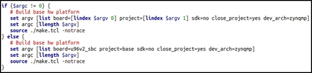

Anatomy of a Build Script
To get an understanding of what happens when we launch a scripted Vivado build, let's take a look at a sample build script and follow the chain of events that occur.  For this example we will examine
the make_u96v2_sbc_base.tcl build script.
This script doesn't look like much, but the whole build process starts here.  This script specifies:
  • The name of the board we are targeting:  board=u96v2_sbc
  • The name of the project we are building:  project=base
  • Whether or not to also build any standalone software via the Xilinx SDK:  sdk=no
  • Whether or not to close the Vivado project when the script completes:  close_project=yes
  • The device architecture of the target device:  dev_arch=zynqmp
These arguments get passed to the make.tcl file, which will then:
  • Examine the arguments to make sure they are valid
  • Set the TCL environment variable for the location of the BDF files (relative to the hdl git repository)
  • Set environment variables to specify locations of the board, IP and project files
  • Launch the project-specific build script in the project_scripts subfolder: u96v2_sbc_base.tcl
  • Build any specified software via the Xilinx SDK (deprecated, SDK now replaced with Vitis)

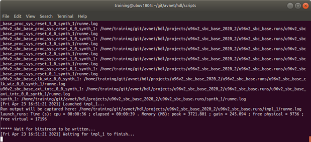

Launch the Vivado Build Script
From the Command Line:
$ cd ~/git/avnet/hdl/scripts
$ vivado -mode batch -source ./make_u96v2_sbc_base.tcl
The build will begin and the terminal window will display the progress as the block design is created and the design is built

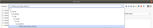

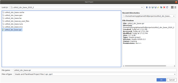

Once the build is complete you can open the design in Vivado.
$ vivado &
Click on Open Project in the Quick Start GUI pane and navigate to the projects/<project> subfolder.
Select the project name and click OK to open to open it.
Follow the steps in Examine the Completed Design below.

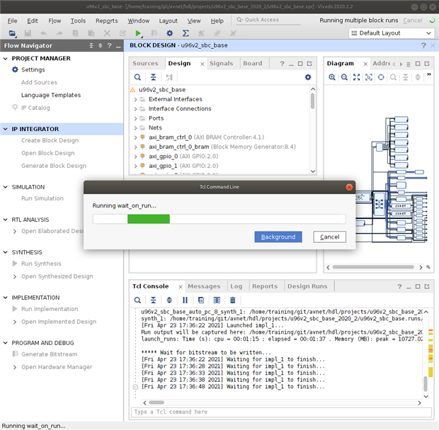

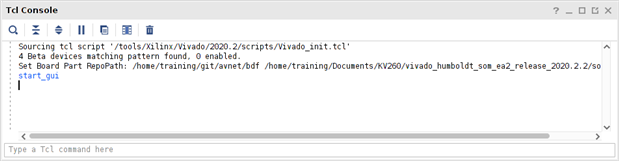

From the Vivado GUI:
Launch the version of Vivado that matches the branch checked out of the "HDL" repository and navigate to the TCL Console window.

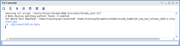

Navigate to the <>/hdl/Scripts folder.

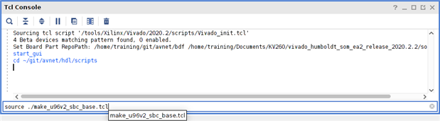

Launch the build script.
The build will begin and the GUI will display the progress as the block design is created and the design is built.

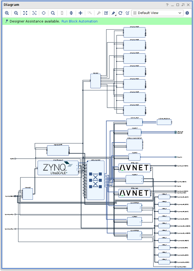

Once the Vivado design has finished building you can open the block design to examine how the design was built and customize it for your own needs.
The Value of a Known-Good Design and Starting Point
The key idea behind these TCL build scripts and this "hdl" github repository is to easily create a known-good design targeting an Avnet SOM or SBC quickly, easily, and repeatably.  Being able to start a Xilinx design from a known-good starting point is critical when designing with complex devices like Zynq and Zynq MPSoC.  There are many device PS and PL IP configuration details, from memory controller setup and clocking settings and I/O constraints, etc., that can cause hours and days of anguish to debug if they aren't done correctly.  For the engineers at Avnet these build scripts have the added benefit of providing a starting point when it is time to update a published reference design.  Public users are also welcome to use these repositories and contribute.
