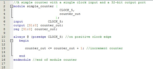

Here's the Verilog HDL code that went into making the "simple_counter" object in the schematic above, as you can see it has an input and a output described, you can see these displayed in the schematic above. Notice how the structure is similar to other programming languages and it's pretty easy to follow.
Once this object has been saved we can add it to the schematic and link other objects to it, the design suite draws the object for us, we don't need to do anything like that ourselves.

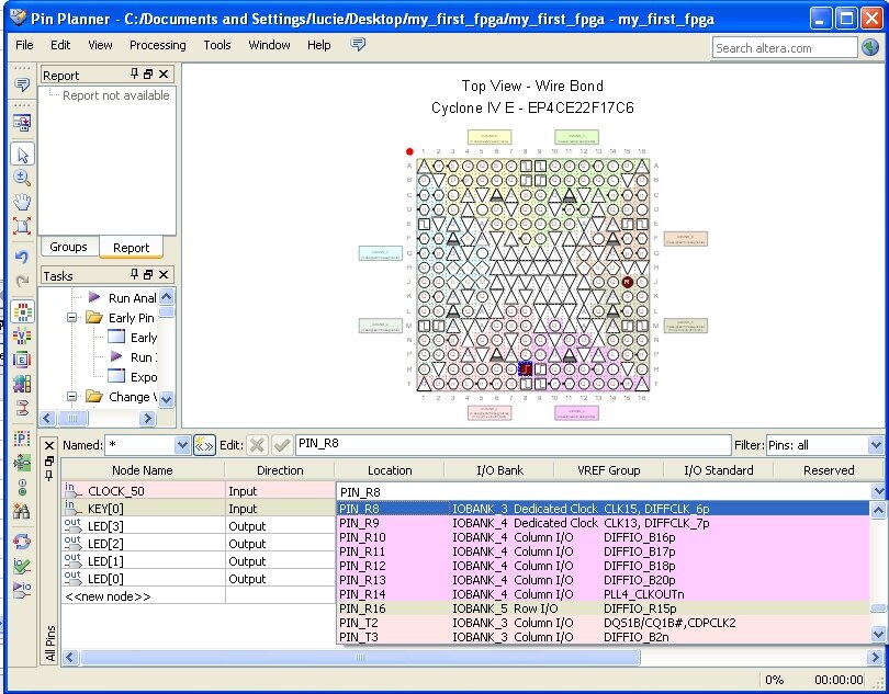

Once our schematic is complete, its time to launch the Pin Planner. If you look at the table at the bottom of the Pin Planner under node names, we can see the names of the input/output pins in our schematic above. In the location box is where we assign the pin in the schematic to the desired pin on the physical FPGA. In this picture, I double clicked the location box for "CLOCK_50" and a drop down list of all of the pins on our fpga device appeared. I selected PIN_R8 which is a dedicated clock pin, so looking back at the schematic we can see that CLOCK_50 is going to be turned on and off by a clock source on the fpga.
Heres the completed pin assignment. This can be opened up at anytime during the design process to assign new input/output pins.

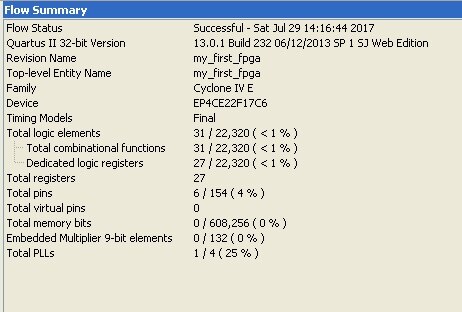

Once this is done your project is finished and its simply a case of clicking the compile button, plugging the de0-nano into a USB port and copying the compiled bitstream program onto the fpga using the programmer in the design suite. I have included any pictures for the process as it really is simple and self explanatory. There are pictures and a step by step guide in the my-first-fpga document but I have included a picture of the compiler report that was generated:
As you can see, very few of the fpga's resources were used to make this project.

    You won't get pauses -- you'll just get an 8-bit counter instead of a 4-bit counter.  If you want to pause, you need something like (in Verilog): "LEDs = counter[24]? counter[23:20]: 4'b0000" which means if counter bit 24 is 1 the four LEDs count but if counter[24] is 0 they show the value 0000 for 16 ticks.
