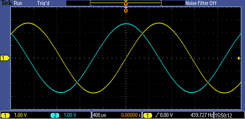

I'm going to utilise the Lattice XP2 Brevia 2 board, along with a Pimoroni audio CODEC, that I previously used in this blog:
Quadrature Sinewave Generator on Lattice XP2 using Brevia 2 Development Board
replacing the Taylor series calculation with the CORDIC one. There's nothing special about the XP2 - the CORDIC component should run on any FPGA that has sufficient logic elements to suffice for the resolution chosen - it's just convenient because it saves me building anything fresh for the moment.

What I'm going to do
I'm not going to do anything too complicated to start with, just compute full-amplitude, 16-bit, fixed-frequency sine and cosine with the CORDIC component and feed them as right and left samples to an I2S component that outputs to the DAC on the Pimoroni board. That fits comfortably in the 5k logic elements of the XP2 part. I've chosen 440Hz for the frequency and this time I'm working 48ksps - no particular reason, other than to try something a little different.
Here's the VHDL. Two component files, and a top-level one to tie it all together. On Lattice, you may need to use Synplify for the synthesis, rather than LSE.

Results
Here are the output waveforms displayed on an oscilloscope.
This is the line output from the Pimoroni board. To achieve those high levels, the DAC part has capacitor switchers to generate the voltage rails.
This is the FFT of one of the waveforms.
It's not all that pure - there are obvious traces of the harmonics poking up from the noise floor of the 8-bit scope sampling if you work across from the fundamental at 440Hz. This is the same thing I saw when the waves were generated with a Taylor series, so it strongly suggests that the problem lies with the output DAC and not the calculation.
Also, the frequency is a little bit off. It could well be that I calculated the phase increment wrongly, but I think that it's actually the fault of the 12.288MHz xtal oscillator. So I'll need to have a look at that.
Usage is about 30% of the '5K' XP2 device on the Brevia 2 board.

    Here is the sine and cosine in more detail
    and here's the spectrum view
    with, and this surprised me, a THD figure of 0.005% (if you look closely, there isn't anything much at the actual harmonics). So the CORDIC calculation of the sine must be fairly accurate. Presumably the other lines, clustered around the fundamental, are intermodulation products (but what would be the source of the interference?).
