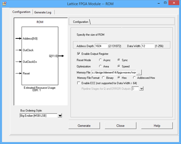

in the background. With Diamond, it turned out that there is an intermediate step where a utility within
Diamond, called IPExpress, allows primitives like memory elements to be selected and configured, and a
module to be automatically created to include in the project. Once the module is available, the element
can then be simply declared as a component in the VHDL and the connections achieved through an
instantiation statement.
Here's a view of my module in IPExpress:
After selecting ROM from the list, putting in a filename for the module and selecting the language (VHDL
in my case), clicking on the customize button brought up this dialog box:

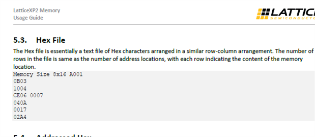

That should have been straightforward too, except that I got an error on loading the Memory File that I'd
generated with a sine table in it. Here's what the Lattice documentation gives for the format:
Unfortunately it's wrong. There is no header line and it should just be a list of values, one on each
line. Including the 'Memory Size ...' part in the grey box looks like it was someone messing up the
formatting of the Technical Note. Once I'd puzzled that one out it was all plain sailing.

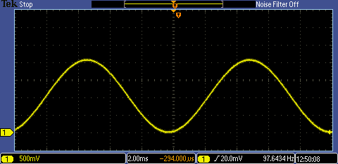

I adapted my original VHDL so that the counter connected to the ROM address lines and the data from the
ROM went to the shift register and this was the nice result from the DAC:
Unfortunately, it's not quite so nice at the lowest point, though I already knew that would be the case
from doing the last blog.
Here the sine shape is compromised by the way the op-amp buffer in the DAC behaves near ground. Not only
does it limit the lowest value, distorting the shape of the waveform, but also it seems to take its time
lifting off again and the noise rejection seems much poorer (the 'scope is set to a one second
persistence time).
