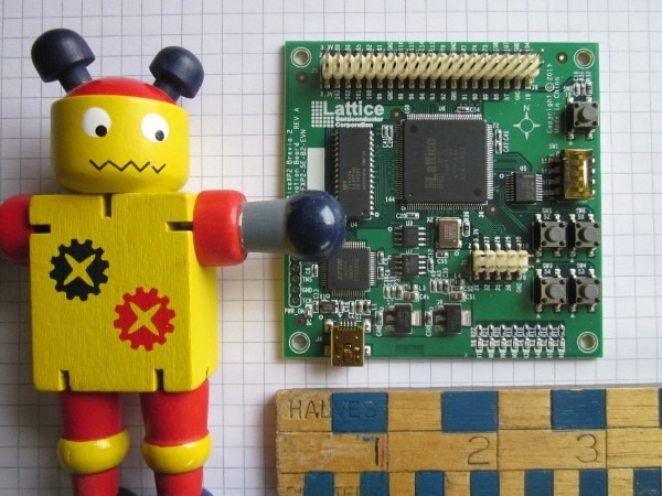

I have a small Brevia 2 development board [1] from Lattice Semiconductor, with one of their XP2-family FPGAs on it, that I bought from Farnell a while back. Last year I got as far as doing these two blogs before getting distracted and going off in quite different directions.
Booards and Boojums: Lattice XP2 Brevia2 Board: Part 1
Booards and Boojums: Lattice XP2 Brevia2 Board: Part 2: Count Those LEDs!
It's time to have another play with it.
Here's another picture of the board to give an idea of the size and what's on it. [The ruler is an old school one and has an inch scale - sorry if you prefer metric measure. In metric, the board measures 76.2mm x 76.2mm.]
The FPGA on it is an LFXP2-5E part. It is the smallest member of the XP2 family with just 5K LUTs [Look-Up Tables]. The evaluation board has several nice features to it, even though it's very simple: it can be programmed through the USB connection, without needing a separate programmer, using the Lattice tools as they understand the interface; the USB provides a second channel that can be used for RS232 communication between a PC and the FPGA; and there are 0.1" headers that make prototyping of hand-wired daughterboards particularly easy.
There are several things I'd like to try with it. One of those is (inevitably!) to explore making a specialized processor of some kind, but that would be too involved to start with so, instead, I thought I'd have a go at using the board to generate some waveforms.

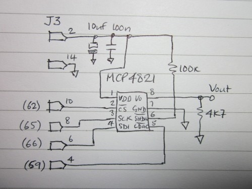

The development board doesn't have any analogue I/O so I need to add a DAC (Digital-to-Analogue Converter) and, in order to keep it all nice and simple, I'm using one with an SPI bus interface from Microchip - an MCP4821 part. It's 12 bits resolution, has an in-built 2.048V voltage reference and the output is buffered with an op amp. It's available in an 8-pin DIL package which will make prototyping very easy.
Here's the circuit diagram I started with. There's not much to it really. The DAC can work on a supply up to 5V but I'm going to run it on the 3.3V from the Lattice board. I've got a 10uF electrolytic and a 100nF ceramic on the supply (which the datasheet recommends) but, other than that, no further supply filtering; it will be interesting to see how good a job the device does of rejecting supply noise.
The connector on the left is numbered to match connector J3 on the Brevia board, the numbers in brackets are the FPGA IO pins which they connect to: I'll need those when I'm doing the code, so they're on there as a reminder and to save me having to look it up.

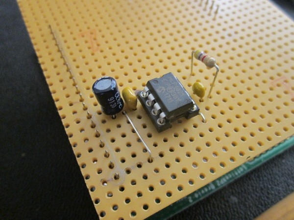

I wired it up on a piece of stripboard; it looks like this:
It's all very minimal but it will enable me to look at how the DAC behaves before I do anything else with it.

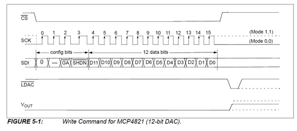

My starting point for doing this is to look at the datasheet for the MCP4821. That gives me this nice waveform diagram with most of the information I need on it. It shows me the waveforms I'm going to need to generate with the FPGA; I just need to refer to a few of the items in the AC timing tables and quickly read how those control bits function and then I'll have a clear idea of where I'm going.
The SPI interface to the DAC is very simple: it's write-only, so I'm only going to be sending data to the device and there is only one single 16-bit command which, very conveniently, combines the few control bits with the 12-bit data value that will control the DAC and produce the output.

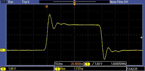

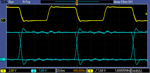

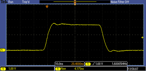

First a quick look at the SPI clock waveform I'm generating. Here's what I saw the first time I tried it.
Ouch! Look at that overshoot and ringing. There's about 5 or 6cm between the FPGA and the DAC chip without termination - along the track on the pcb, up the pin of the 0.1" pitch connector and then down a short length of track on the stripboard -  and that's the result. What's the rise time? The scope says a bit over 1.7nS, but that's meaningless because that's about the risetime of the oscilloscope itself; it could be faster, but I'd never know. It also means that the waveform we see isn't necessarily an accurate reconstruction of what's there, though I think we can take it as read that it  overshoots nicely.
My first thought was to try terminating it in some way, but FPGAs usually have control over slew rate and drive strength on the IO pins, so, after a quick scurry through the help material, I worked out I could select a "SLOW" slew rate and a drive strength of 8mA (that was the lowest option for 3.3V CMOS) and tried that. This was the outcome.
That's much more comfortable and will do me for what I need for this blog.

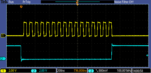

Here's the clock [yellow] in relation to the SPI ncs [blue] that I'm generating with the FPGA.
That shows that I've generated the right number of clocks (16) and the rising edges sit nicely within the chip
select active (low) period, as they should. So far, so good.

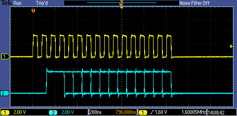

This next one shows the clock (yellow) relative to the SPI data (blue). The static control bits are in the
right places and have the intended values and we can see that the data values are changing.

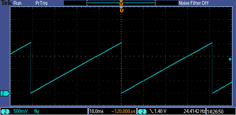

Now, moving attention to the output side, this is the Vout of the DAC chip
It works! I've got a ramp from zero to just above 2V at the right sort of repetition rate [1/(10uS x 4096) = 24.4141 Hz].

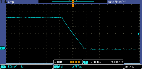

The portion from the maximum value down to the minimum value will allow me to look more closely at how the op amp slews - here it is in more detail
The fall time is around 2.8us, which gives a slew rate of about 0.73V/us. That's faster than the datasheet typical figure of 0.55V/us but their test is done with 100pF on the output which will be slowing it a bit.

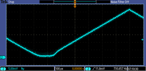

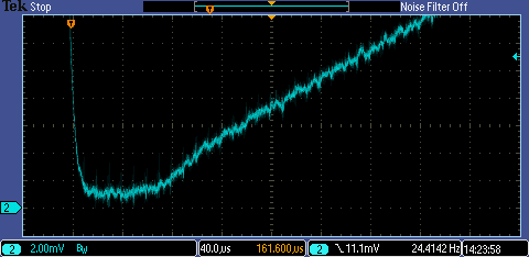

This is what happens at the bottom, just above zero volts.
It makes a bit of a mess of things in the area up to 5mV. More on that a bit further down.

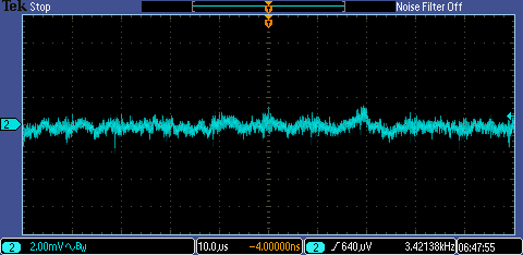

Next, I removed the counter that stepped the DAC to produce the ramp and substituted a fixed value of 2048. That gave me an output level that, on a single shot, looked like this

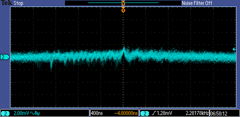

That shows the noise [it's with the oscilloscope's 20MHz bandwidth filter on, so some of the high frequency noise has been removed].
This next trace shows the same thing but with multiple traces and we can now see that there's some structure in the noise. The trigger point is the end of the SPI chip select and is where the DAC gets loaded with its new value. Just prior to that we are seeing a small amount of breakthrough from the SPI clock and data lines - probably not surprising given that the analogue side is sharing a ground with the digital lines.

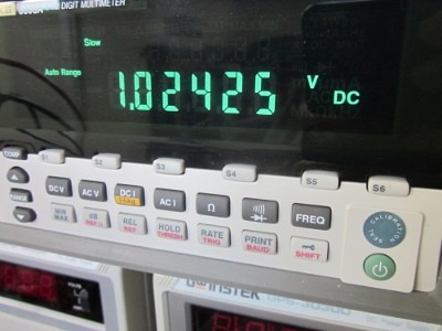

Whilst I had the output constant I measured the DC level. This for a DAC value of 2048 which should be half scale, 1.024V.
After it's been on for a few minutes, that rises and levels out at 1.02436V. Yesterday, I was seeing values of around 1.02440V.
It's not so good at full scale. Rather than 2.048V, it measures 2.0460, though that's much better than the datasheet min and max values of 2.008V and 2.088V respectively suggest.
This next trace shows the DAC output after I'd hacked the VHDL to limit the range and step from 0 up to 63 and back down again to give a triangle waveform rather than the sawtooth.
That allowed me to see better how the internal op amp that buffers the DAC output behaves at the bottom of the range. According to the datasheet it can get within 10mV of the rail but this suggests it is behaving reasonably from about 5mV upwards and only gets into trouble below that. [That's with a 4.7k load resistor to ground, which maybe helps the op amp a little.]
This particular trace allows the individual steps of the DAC (0.5mV) to show through. This is with the 20MHz bandwidth filter of the oscilloscope enabled.
