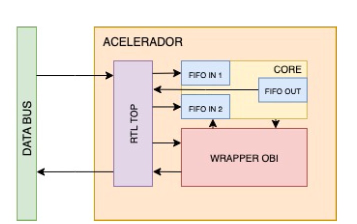

The accelerator
The current version supports two operations:
  • Dot product
  • Cross product

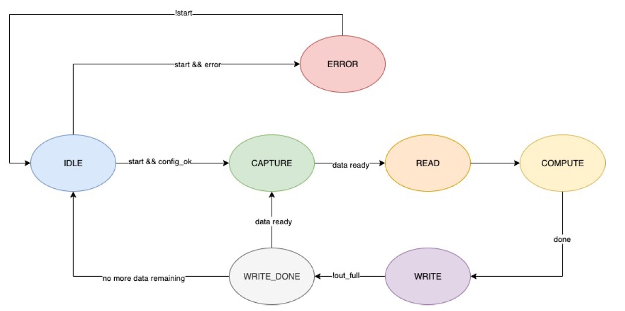

The design uses two input FIFOs and one output FIFO. Internally, a finite-state machine controls the complete process, from reading the vectors to calculating and storing the result.
I also developed a wrapper with an OBI-compatible register interface, allowing the processor to configure the operation, select the number of bands, start the accelerator and read its busy, done and error status.
The accelerator was integrated into the X-HEEP ecosystem, using a RISC-V processor for control and a DMA controller to transfer the input and output data without requiring continuous CPU intervention.

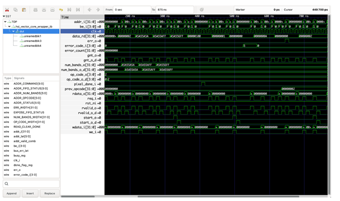

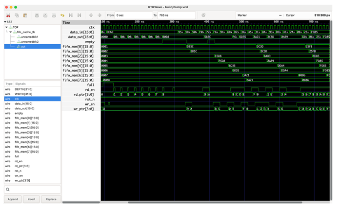

For verification, I used Verilator together with C++ testbenches.
I created individual tests for:
  • The FIFO memories
  • The vector processing core
  • The OBI wrapper
  • The complete integrated accelerator

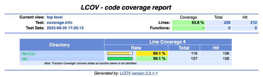

The testbenches verify normal operations, invalid configurations, empty and full FIFO conditions, signed calculations and register access.
The simulations achieved more than 90% coverage over the instrumented lines and signals. I also generated VCD files to inspect the internal behaviour using GTKWave.

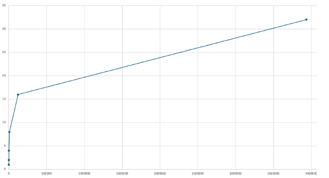

Results
The functional tests confirmed that the accelerator correctly performs the dot and cross products and responds correctly to invalid operations and boundary conditions.

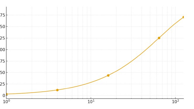

For the cross product, the latency per pixel becomes stable once the finite-state machine has started processing data.
For the dot product, the latency increases linearly with the number of spectral bands because the multiply-accumulate operations are performed sequentially.
The tests also showed something very important: the vector core itself was not the main bottleneck in the evaluated workloads.
The largest limitation came from moving data between memory and the accelerator.
The DMA introduces a fixed startup delay for every transfer. Because each operation requires two input transfers and one output transfer, this overhead has a significant impact when processing only a small number of vectors.
As a result, the software version can still be competitive for small datasets. The hardware accelerator becomes more useful with medium or large datasets, when the initial DMA cost can be distributed across more operations.
The measurements up to 4000000 vectors also showed a mostly linear behaviour, without clear memory saturation or cache-related steps in the evaluated range.
Image above shows the latency vs the compute data size for the vectorial product operations.
