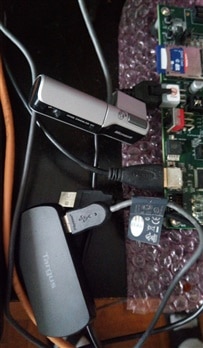

The ZC702 does not have a full sized USB port so a USB hub has to be used. Luckily the development platform comes with a Target 4 port USB hub that plugs into the USB
micro port of the development board. This is a USB host port so it allows using standard USB cameras. A generic USB camera can then be lugged into the USB hub.
This will enumerate as a /video device under /dev folder on PYNQ distro as shown below.
