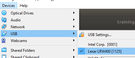

Using a compatible card reader, insert the card and associate it with your Virtual Machine

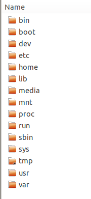

For the purposes of this blog, I will not be talking about the details of setting up an Ultra96V2 SDCARD, but having two partitions, you will want to copy the following files to the BOOT partition and then extract the rootfs.tar.gz to the root partition:
After that is complete, make certain to run SYNC!
