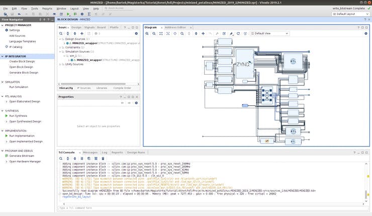

First, we need to open a project we want to modify. Open Vivado search for the project you want to work on. For this example, I will be using the"minized_petalinux" project.
Just double-click MINIZED.xpr and the project should open.
Click "Open Block Design"
As you can see the script you have used generated Vivado project and used it in creating petalinux system for your board!

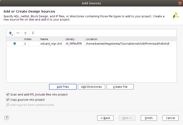

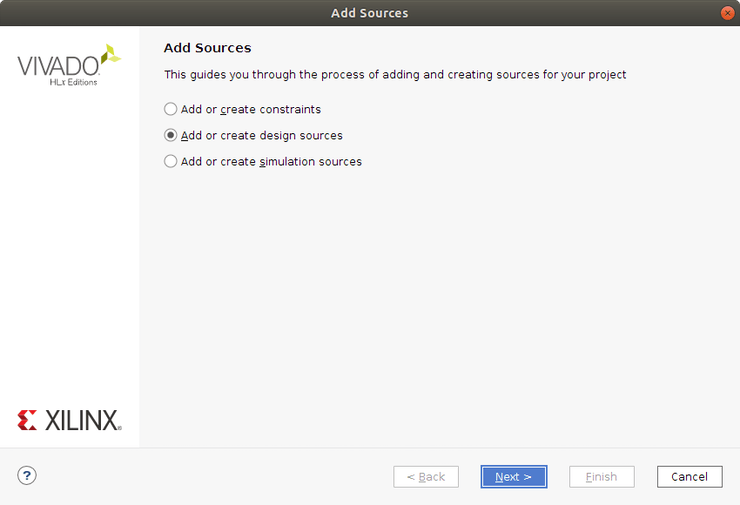

Click "Add Sources"
The dialog should pop up
Click "Add Files" and search for sdcard_mgr.vhd
Click "Finish"

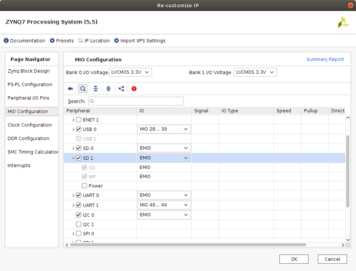

Double click on ZYNQ "ps7" and click "SD 1"
Now modify ZYNQ PS to use EMIO ports instead of MIO.
Set SD 1 to EMIO and click "OK"

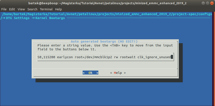

Go to DTG settings -> Kernel Bootargs
add "clk_ignore_unused"
Exit popup while saving changes.

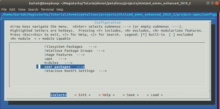

Type:
petalinux-config -c rootfs
Go to "user packages"
and turn on additional packages
If you are missing some library just go to "Filesystem Packages" or "Petalinux Package Groups" and add some, like python3, opg, openAMP or TOOLS TO FORMAT EMMC from ZYNQ.
