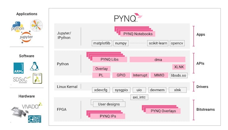

PYNQ is a project by Xilinx that brings Python level productivity to FPGA's. It allows a designer to import hardare designs called overlays in PYNQ parlance and write Python code to address and configure the cores.
This makes designs much easier compared to writing low level C code on the SDK everytime the device needs to be configured.
This speeds up development by an order of magnitude compared to bare metal designs. As of 2020 PYNQ V2.5 uses a Petalinux Kernels with a UBUNTU 28.04 Rootfs.

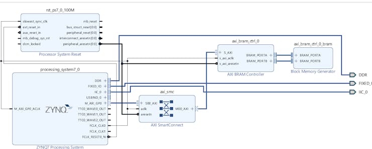

Create a basic Vivado design. I created a custom Vivado design targeting the ZC702 with a BRAM, 1 GPIO targeting the built in LEDS's and switches and an AXI IIC core deployed on the PL that shares the same I2C pins located on the FMC.
In this project we will read and write to the BRAM IP from the PS side..

To test the PYNQ framework a custom Vivado HW will be designed. The block diagram below shows the BRAM connected to the AXI interconnect.
From the Vivado design export the block diagram, the bitstream and place them both in one folder.

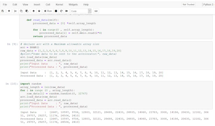

Copy the folder with the notebook ( iPython Notebook) attached at the end as well as the tcl file and bitstream on the ZYNQ via winscp and open it by navigating to pynq:9090\ folder location.
To test the PYQN framework we will build test setup with a BRAM IP an test it. First the bitstream is loaded.
The data is then printed on the Notebook.

The framework was tested by reading and writing data to a BRAM IP block.
