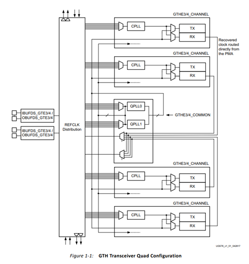

Transceivers!
UG576

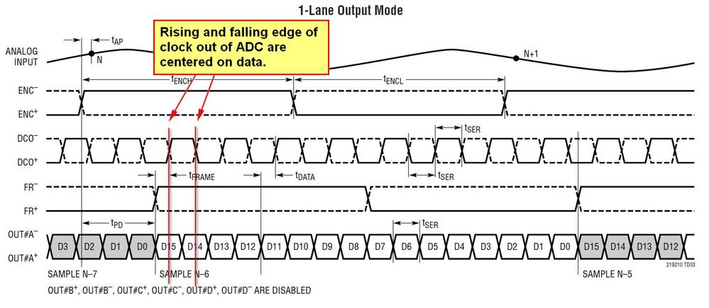

Why transceivers?  Well, as speeds get higher and higher, you have to "get" that data from one point to another.  To do that, it makes sense to go wider and slower.  The problem is as time of flight gets smaller and smaller, your margin for getting all of the data lines to line up at the same time as the proper location of your clock or sampling trigger gets harder and harder.
(unrelated, but the image demonstrates lining up data with a sampler signal (clock in this case) - Xilinx Forums post)
People working with high data rates have long since known this and you see a LOT of data and signaling schemes to try to combat these issues.  One thing is clear, using an ANALOG signal to read our digitally encoded data in as FEW lanes as possible is the way to go with currently technology.

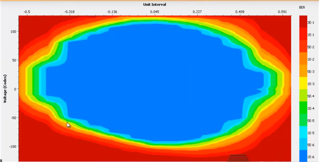

Well, in high speed applications we start to have to worry about signaling MARGIN.  You can think of this as the "fuzzy" levels in our signal that can be interpreted as our data.  The more margin, the more room for error there is.  These can be seen as "eye diagrams".  As data is overlayed to a graph, you get a sense of just how much margin you have.  Larger centers of eye-diagrams are better, but too much is also bad.  There is a balance and every situation can be different.
This image taken from Tech Tips 104 - XILINX and IBERT  Video 4 Getting More Margin 2.  This is a series of training videos I produced a while ago.They teach you how best to tweak and tune transceivers on a Zynq-7000 based PicoZed.  The steps can be applied to just about any transceiver tuning.
Transceiver Tech Tips - Tuning Your Transceiver

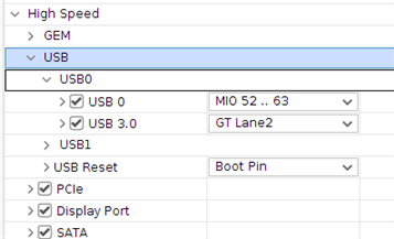

Right - so with that background knowledge, how does the MPSoC connect to USB?  For the Processing System (PS), it has two internal pieces of hardened IP.  One is the ULIPI USB 1.1-2.0 driver / transceiver, the other is the GTR based USB 3.0 IP.  GTR?  Didn't you mention GTH above?  I sure did!  The Xilinx Zynq-UltraScale+ MPSoC supports both GTH and GTR transceivers.  GTR is a special transceiver that has been used for supporting the Matrix of features the MPSoC's PS provides.  This includes Ethernet, PCIe, Display Port, and SATA.
Knowing that the USB 3.0 is a transceiver, that gives us a LOT of information about how this works.   Especially knowing that something is USB 3.0 is only half the story.  You then have to consider the TYPE of connector.  USB A, B, C, Standard, Micro, Mini.

Essentially, what I believe has been happening, people are running out of margin.  Without proper high quality cables, the eye is closing and we are seeing a loss of link, which then most (all?) USB 3.0 devices tend to drop back to USB 2.0.
I can say with personal experience that running a USB 3.0 webcam on an Ultra96V2, using it's USB-A SuperSpeed connector is possible and does work well.  I can also say that using a USB 3.0 webcam on an UltraZed-EV is also possible.  You just have to watch your signaling.  I have not had success using "cables" from EBay nor "sort by $ vs $$$" on other online stores.  I HAVE had success with a webcam that had a Micro-A SuperSpeed cable as well as using a HIGH Quality adapter such as the one from WhizzSystems.
