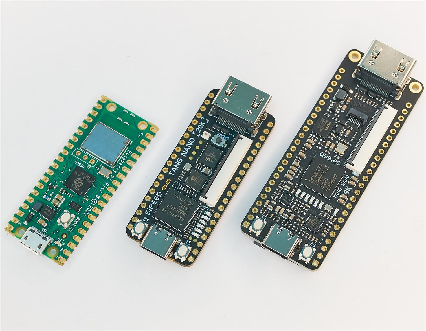

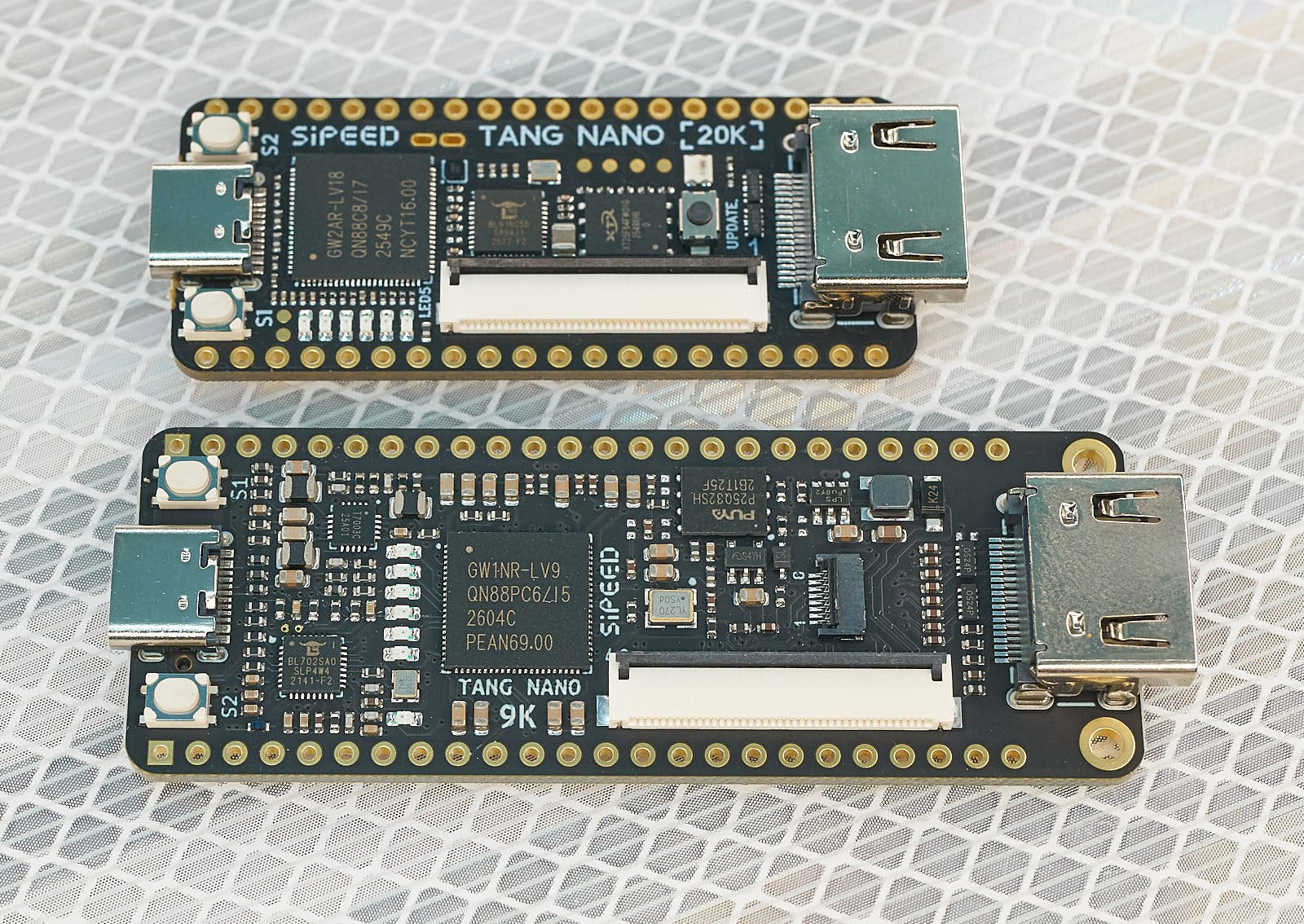

The Tang Nano series uses FPGA parts from Gowin, and they are available in a range of sizes. The photo here shows the 9k and the 20k variants (the 20k one happens to be on a physically smaller board, but is more powerful). There is also a 1k variant, but it was missing from the photo shoot. I misplaced it when I took the photo : (
These boards mostly come with a USB connection at one end, some have a HDMI connector at the other, and all remaining signals (it’s an FPGA board, so you can assign what you want to them all) are on solderable pin header connections, but there’s also a flat flex connector intended for a TFT screen, but again, as it’s an FPGA board, you could repurpose these connections for something else if desired.
In terms of other built-in hardware, there’s a micro SD card slot on the underside, and a few buttons and an array of LEDs on the two boards in the photo.

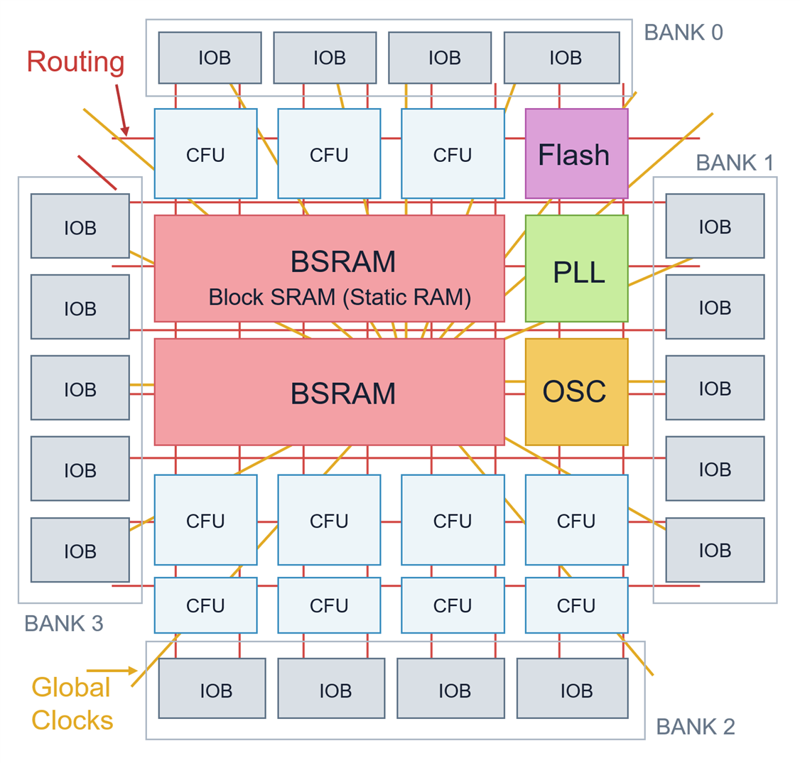

Here’s an attempt at an explanation. The diagram here shows what’s inside Gowin FPGAs (some Gowin parts feature additional functionality). From a bird’s-eye view, it can be seen that the most common thing is a Configurable Function Unit (CFU) and there are lots of them (typically hundreds). Each CFU can perform a small amount of logic functionality, and there are interconnections possible across the entire chip, using a feature known as routing, indicated with red lines in the diagram. Part of the bitfile programs up the CFU to perform what it needs to do, and part of the bitfile represents what routing is needed between them all.
Routing can be a bit slow, so there are also a few configurable clock signals that fan out from the center (yellow lines), to allow each CFU to latch operation results on clock edges and synchronize the project. The FPGA contains oscillator and frequency multiplication capability (PLL), so that all you need to do is attach a crystal and you can derive several clock frequencies from that.
All around the chip are the input/output blocks, which can operate at different logic levels in banks. The I/O blocks take configuration from the bitfile, to determine if they should become inputs or outputs, what drive strength, and whether differential signals are required and so on. The I/O blocks connect to the routing, in order to ultimately make a connection to a CFU, not necessarily a CFU closest to an I/O block. Each I/O block can contain several GPIOs incidentally, or can be grouped for (say) differential input or output.

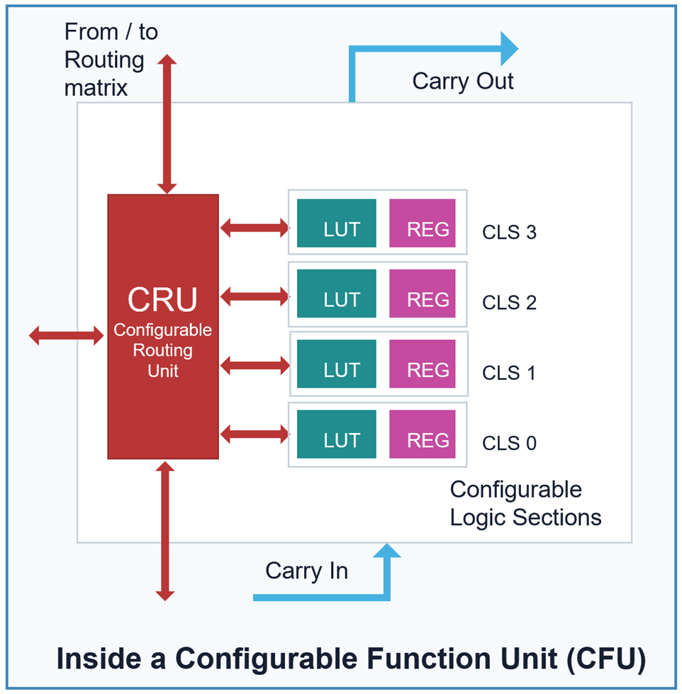

Zooming in a little bit into a CFU, and you’ll see this:
The routing unit is used to attach to all the routing, and, again based on bitfile content, will become configured when the FPGA starts up and loads, to pass signals between different CFUs or other entities, and also between the entities within the CFU.
Ordinary combinatorial logic (such as AND, OR gates) can be implemented with memory tables (for instance, for a two-input AND gate, you could call the inputs two address lines, and store the values 0, 0, 0, 1 in memory address locations binary 00, 01, 10, 11) and so it’s no surprise that the Look-Up Tables (LUTs) could be thought of as RAM that is loaded from the bitfile, to create all the logic that was expressed in the code (actually HDL, or Hardware Description Language) that the developer wrote to get turned into the bitfile.
The registers combine with the LUTs to produce clocked logic circuits, and these can (for instance) get inferred when the user types particular HDL content.
Particular operations need to happen speedier than routing, so carry logic (used for arithmetic) can span to the next consecutive CFU; that’s more efficient than trying to make the routing do it all, and the FPGA compiler is smart enough to know when to use the carry logic rather than routing.

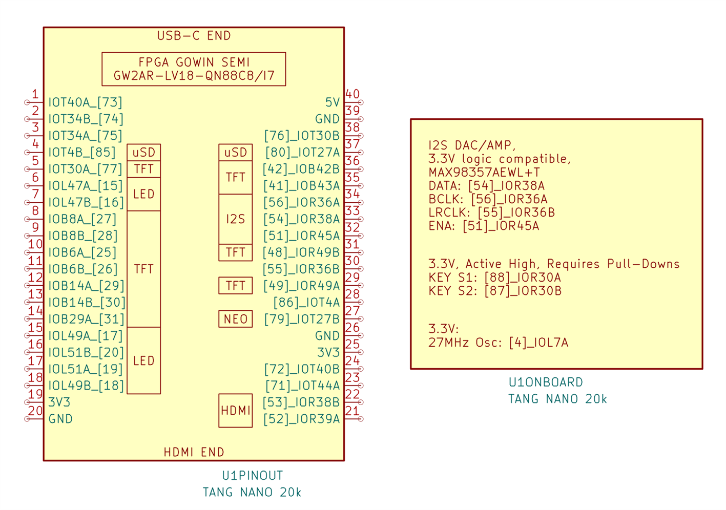

Tang Nano Pinouts
The documentation for the Tang Nano boards is pretty good; there are schematics downloadable from Sipeed, and the actual FPGA datasheets and so on are available directly from the FPGA manufacturer website (GOWIN).
Still, there’s a lot spread out to make sense of. I decided to make some simpler-to-understand symbols, although one will still need to consult the schematics, especially for the on-board features.
The naming of the I/O pins looks a little confusing. The Gowin terminology is to label them beginning with IO, followed by a character T, B, L or R, which represents the top, bottom, left or right side of the die, and then a number which happens to represent either the column or the row number of the CFU (Configurable Function Unit) that I/O pin is close to, just for convenience. Finally, the last character indicates if other pins are close to the same CFU column or row, since useful relationships may be possible between otherwise same-named pins, for instance, IOT16A and IOT16B would identify IO pins at the top of the die, both close to CLB column 16, and can optionally operate as a differential pair.
For the symbols, I stuck with the Gowin terminology, but also added [nn] to the I/O pin names. The [nn] value is the physical pin number on the FPGA chip.
Another important point: on all the Tang Nano boards described here, the voltage labelled connections on the headers are all _outputs_. The only source of power should be from the USB-C connector.

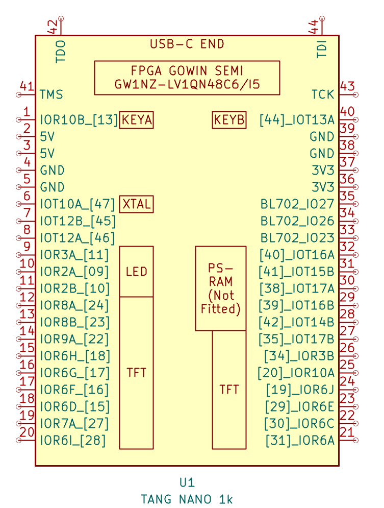

Tang Nano 1k Pinout
Useful links: Tang Nano 1k Schematic, Tang Nano 1k Sipeed Wiki Page
The Nano 1k exposes 32 IO connections onto the 40-way header, but notice that nearly all are already allocated a purpose, for instance, the Nano 1k has two push-buttons built in, and those are to IO pins labelled KEYA and KEYB in the symbol below. Lots of pins also go to the flat flex TFT connector on the board, and those pins are labelled TFT in the symbol. Of course, if you’re not actually connecting a TFT, then you could use those IO pins for any other purpose.
Note that the thee pins labelled beginning with BL702 are not attached to the FPGA, they can be ignored (they attach to a USB microcontroller on the Nano 1k board).
Also, be a little careful when counting pins on the Nano 1k, because there are 22 pins per side, not 20, because two pins per side expose connections for JTAG (unnecessary to use normally), I’ve labelled them pins 41-44 in the symbol below.

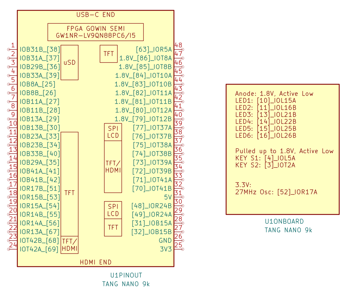

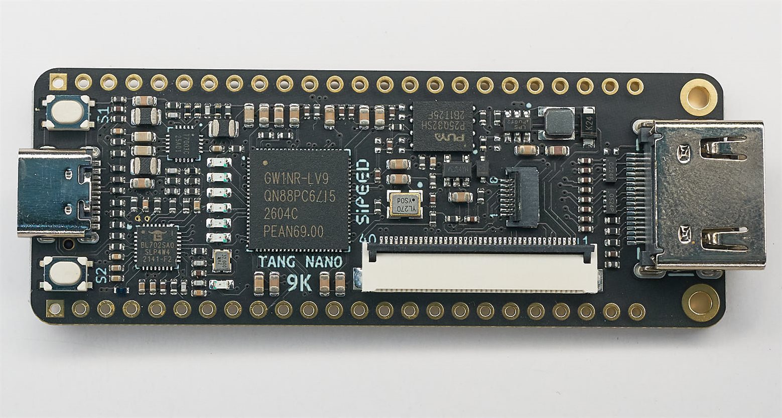

Tang Nano 9k Pinout
Useful links: Tang Nano 9k Schematic, Sipeed Tang Nano 9k Wiki Page
The Nano 9k is one of the physically larger boards in the family. It has 24 pins per row, and has built-in HDMI and micro SD slot, unlike the Nano 1k. Plus, the Gowin part used on the 9k contains 64 Mbit of PSRAM.
Notice that the on-board LEDs and buttons are wired to 1.8V. Some of the header pins are wired to 1.8V IO pins too.

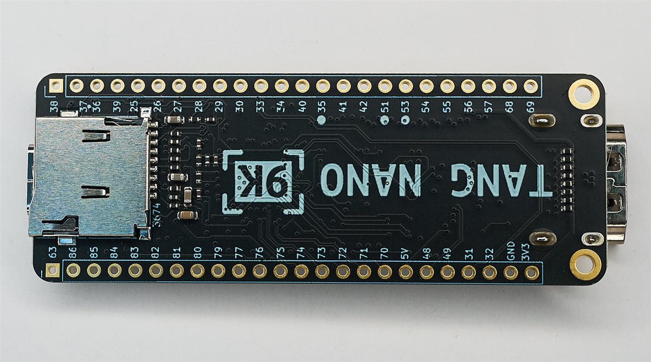

Here are some close-up photos of the board, the black PCB isn't too easy to photograph well, unfortunately. To the left of the HDMI connector, above the TFT flat flex connector, is a smaller flat flex connector for SPI LCD screens.
Not much on the underside, apart from the micro SD socket.

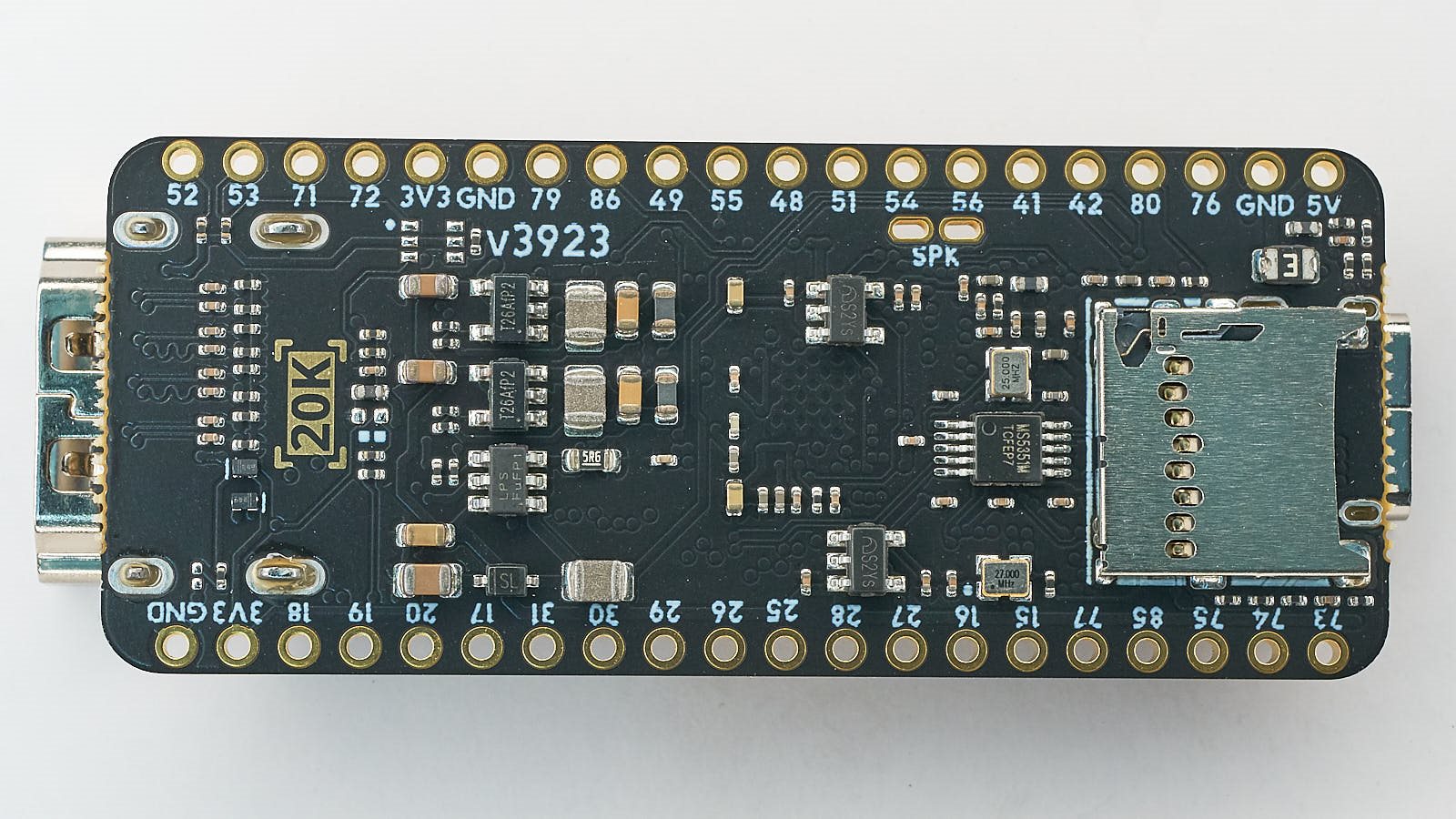

Tang Nano 20k Pinout
Useful links: Tang Nano 20k Schematic, Sipeed Tang Nano 20k Wiki Page

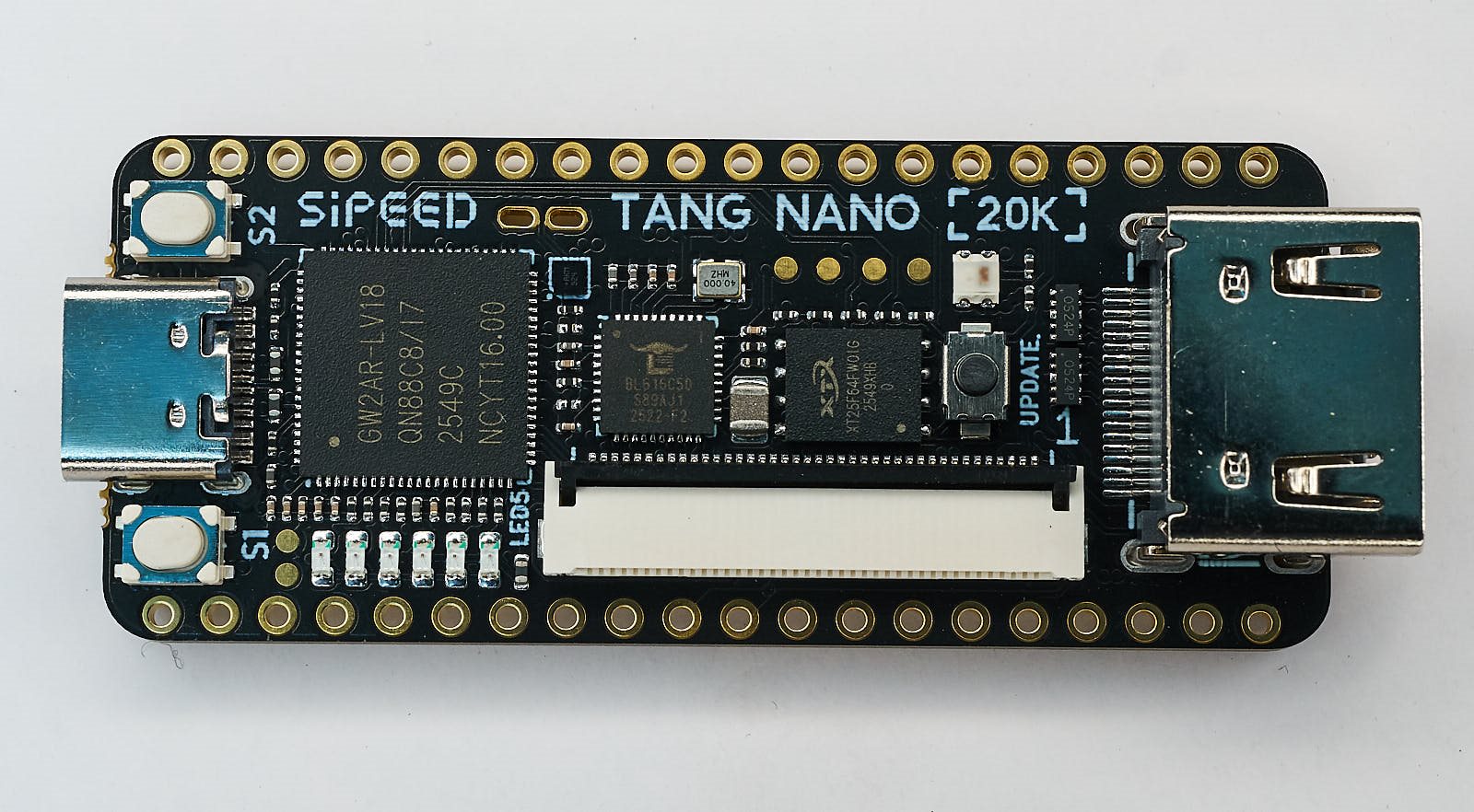

The Nano 20k is a 40-pin board. Like the other Nano boards discussed above, most of the IO pins are already assigned but you’re free to use them for other purposes if there’s no clash. Interestingly, the Nano 20k has some pins wired to an I2S DAC/audio amplifier (MAX98357). There are a couple of pads not shown on the symbol, that can be wired to a speaker.
Photos:
There's a nice frequency synthesizer IC on the underside, MS5351M, which is compatible with Si5351A.

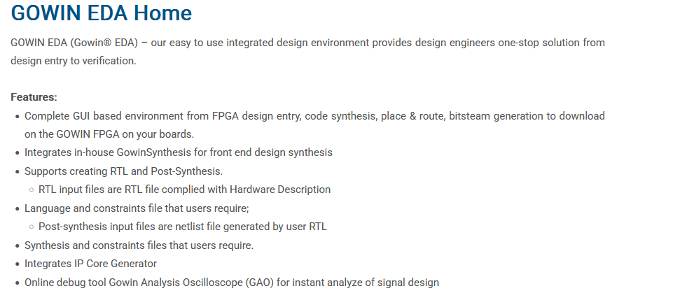

I installed GOWIN FPGA DESIGNER v.1.9.11.03 Education Build, available from Sipeed, or from Gowin. The direct Gowin website is recommended, in case the Sipeed version is old. Besides, the Sipeed download site can be extremely slow, so plan in advance if you wish to obtain software from there.
As part of the GOWIN FPGA DESIGNER install, programmer software should get installed too. If it doesn’t, that is downloadable separately.
The software is pleasantly simple to use; create a project (and select a FPGA device during the project creation process, but you can always modify it later too), then create or add your HDL file(s) and constraint files (this will be discussed later), and then double-click on the circles in the “Process” pane, which will be labelled Synthesize, Place&Route, and finally Programmer, where you can choose to upload to SRAM, or to Flash (SRAM upload is useful for testing, and Flash of course makes it survive power cycling).
I’ll go through all this for an example project in the next blog post, since this one is getting too long.

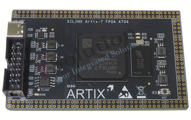

    I haven’t used an FPGA with Gowin yet. I found a nice, minimalist and inexpensive board with an Artix-7:
  • michaelkellett
    michaelkellett 1 month ago in reply to kk99
    Don't tease Slight smile
    Where did you get it (and how much) ?
    MK
  • michaelkellett
    michaelkellett 1 month ago in reply to michaelkellett
    I found it on Aliexpress - here's another one at almost exactly the same price:
    https://www.aliexpress.com/item/1005010517638494.html
    It's worth checking out the support on these low cost boards with big BGA packages on them. Unless you can get a decent schematic, BOM and example projects it is VERY difficult to get them up and running.
    The decent suppliers will give you a link to support materials before you buy.

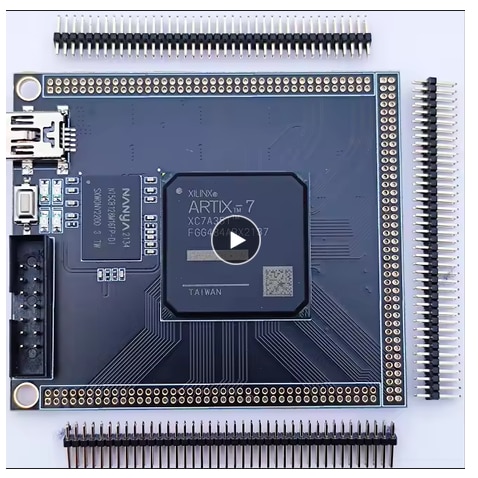

  • kk99
    kk99 1 month ago in reply to michaelkellett
    I got it on Aliexpress: https://pl.aliexpress.com/item/1005008582149431.html
    It was around $65. The seller provided the full schematic and an example project. I’ve also configured the external FT232H to work as a JTAG interface with Vivado 2025.02.
