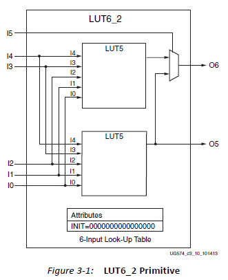

Finally, what is the LUT6_2 primitive? The only difference is that it has two outputs, O5 and O6. You can think of it as two LUT5s with common inputs I0 to I4. The output of one LUT5 is O5 and a mux between the two LUT5 outputs using I5 as the select input becomes O6:
  component LUT6_2
generic(INIT:BIT_VECTOR(63 downto 0));
port(I0,I1,I2,I3,I4,I5:in STD_LOGIC;
         O5,O6:
out STD_LOGIC);
end component;
LUT6_2.O6 is the same thing as LUT6.O and the INIT generic is also identical. LUT6 is actually a subset of LUT6_2, with the O5 output not used. Smaller versions called LUT1, LUT2, LUT3, LUT4 and LUT5 also exist but these are just particular cases of a LUT6, with some inputs not used so LUT6_2 is the basic FPGA LUT primitive, all others are just particular cases.
